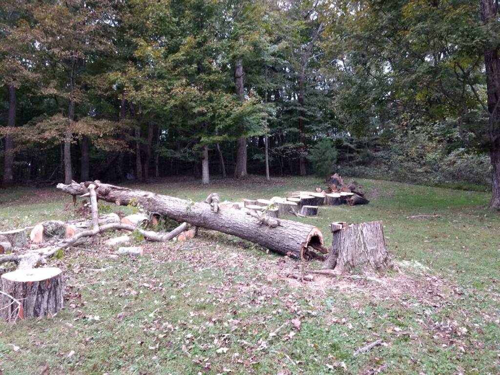

I ran mine for one day on a tree job and couldn't believe how dirty the filter got, I would assume a nice long cut milling would funky it up pretty quick!
After the cutting was done the filter was pretty clogged up...
Half rotten maple dropped on top was butchered as well but no pics after as it was dark.

That didn't leave you much hinge to steer it, eh?
