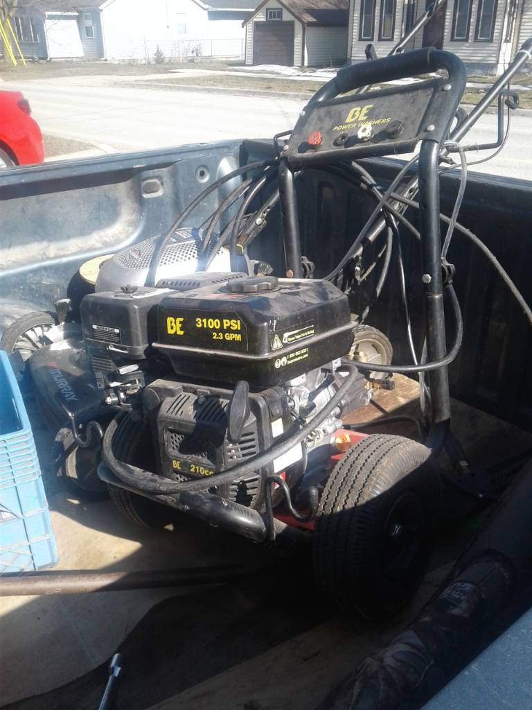

Pump should be fine. He washed his truck turned washer off and says was tight to pull lol.
Soon as he says this he asks. Would you know why it went tight. I pulled tje oil plug and pointed and said thats why ya ran it oit of oil.
I have a extra 5 h.p. techumpse ( i know thats spelled wrong) if this one is pouched. I think it should be ok. Will pull over fine now. May be a bit of a oil burner but time will tell.

The power washer company BE is still in business up in BC. The motor looks like a Honda clone or a Subaru but the carb setup leans me more towards honda clone. Usually Manufactures won t rebadge a real honda because its a selling factor.
As for the pump it looks like the common homeowner model made by the same BE. No repair parts are usually available for them. Just check that the pump oil in the site glass is up to the middle mark. Biggest thing on any power washer is that people don't winterize the pumps or drain all water from the hose and wand in the colder climates and ice tears up all the seals and o rings.
