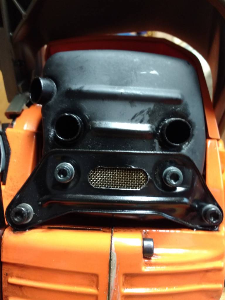

I've been running a Chinese 365 with the BB 372 cylinder for about 9 years. It's ported and runs a modded Zama twin jet carb. The muffler mod I used was turning the muffler bolt tubes into exhaust outlets.

This is how I did mine. I took the screen out of my leaf blower.
