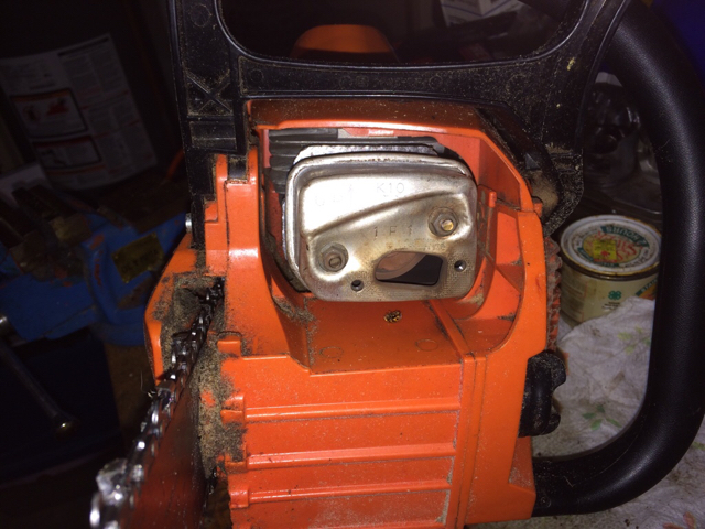

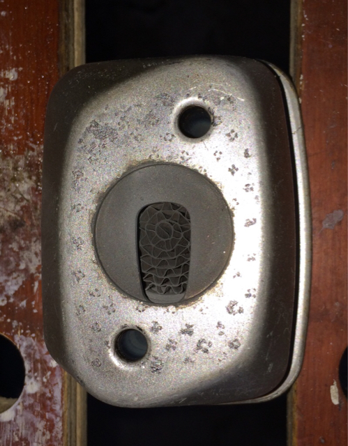

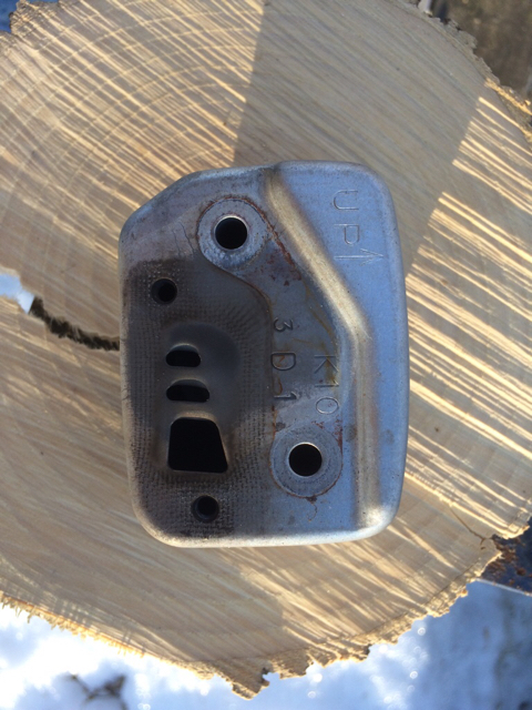

Sometimes you gotta wonder what they were thinking. The CS-400 muffler has a smaller inlet and outlet than their CS-352! Otherwise, they are identical.
Inlet from 400
The smaller 352 doesn't have that oval shaped restrictor in front of the cat.
Outlet from 352
Outlet from 400
Anyway, they are both the same now, and I cut part of the front deflector away on both of them too. Makes for a noticeable improvement[emoji106]
