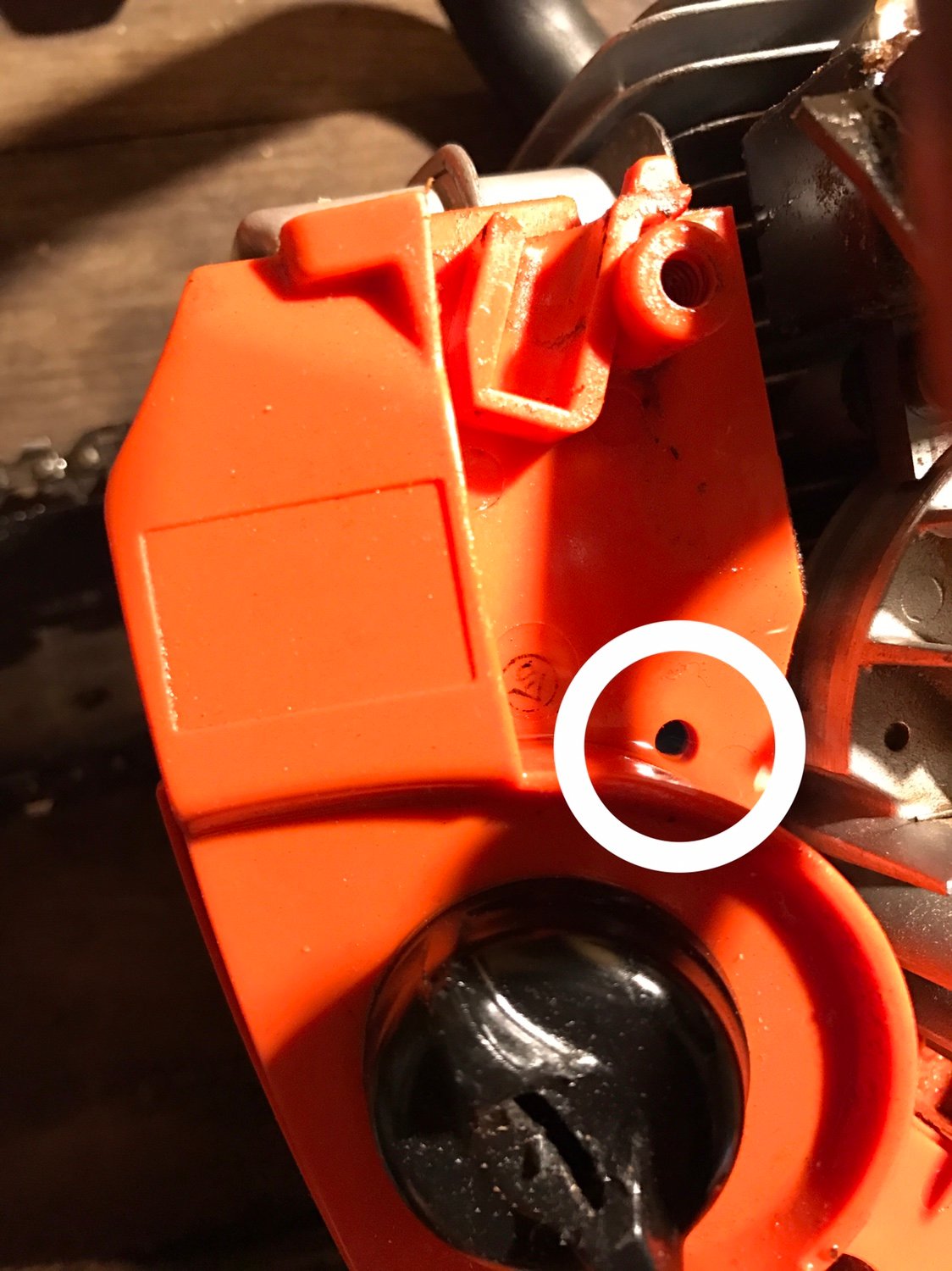

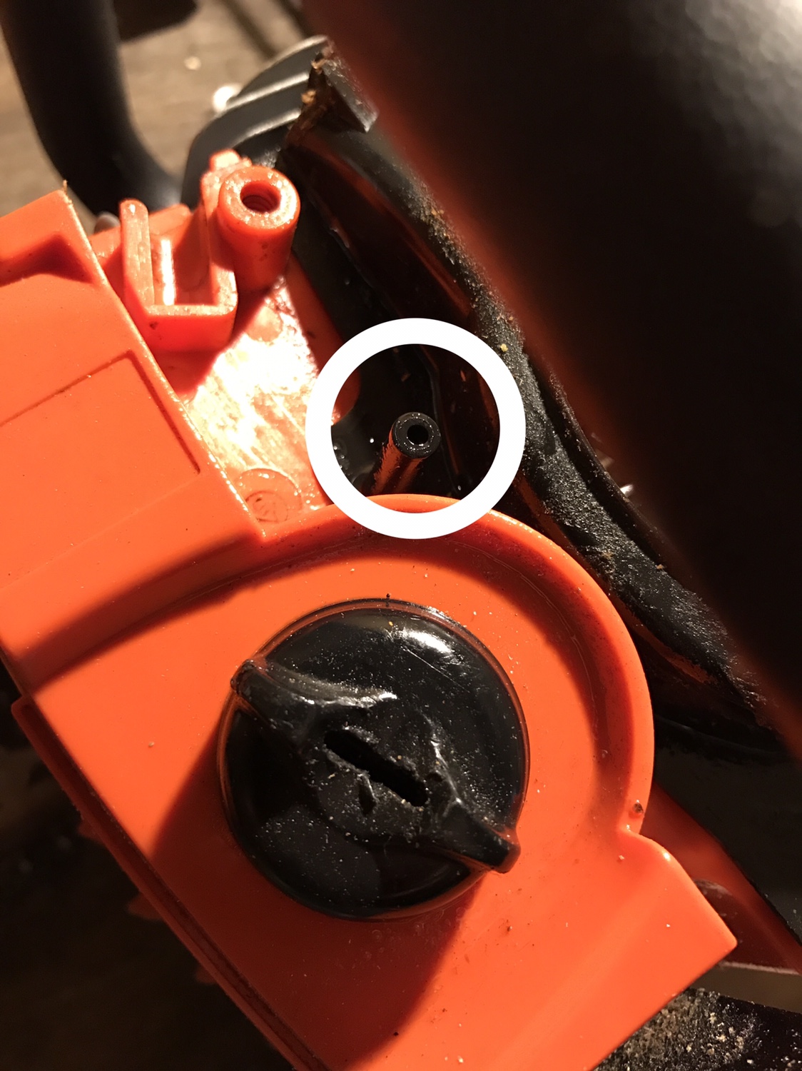

Ahoy there, mateys! Picked up this little Echo the other day, filled it up with gas and oil, ran great! It was late in the day and getting dark, so just brought it in and parked it for the night. Next morning, found oil all over the place. Hmmm! Just figured there was some pressure built up and it leaked out. Ran it again, released the pressure from the cap and set it aside to see what it'll do. Same thing.
Looked it over and saw the oil was coming from the starter side. Pulled the cover off and found the oil leak. Is there something missing?

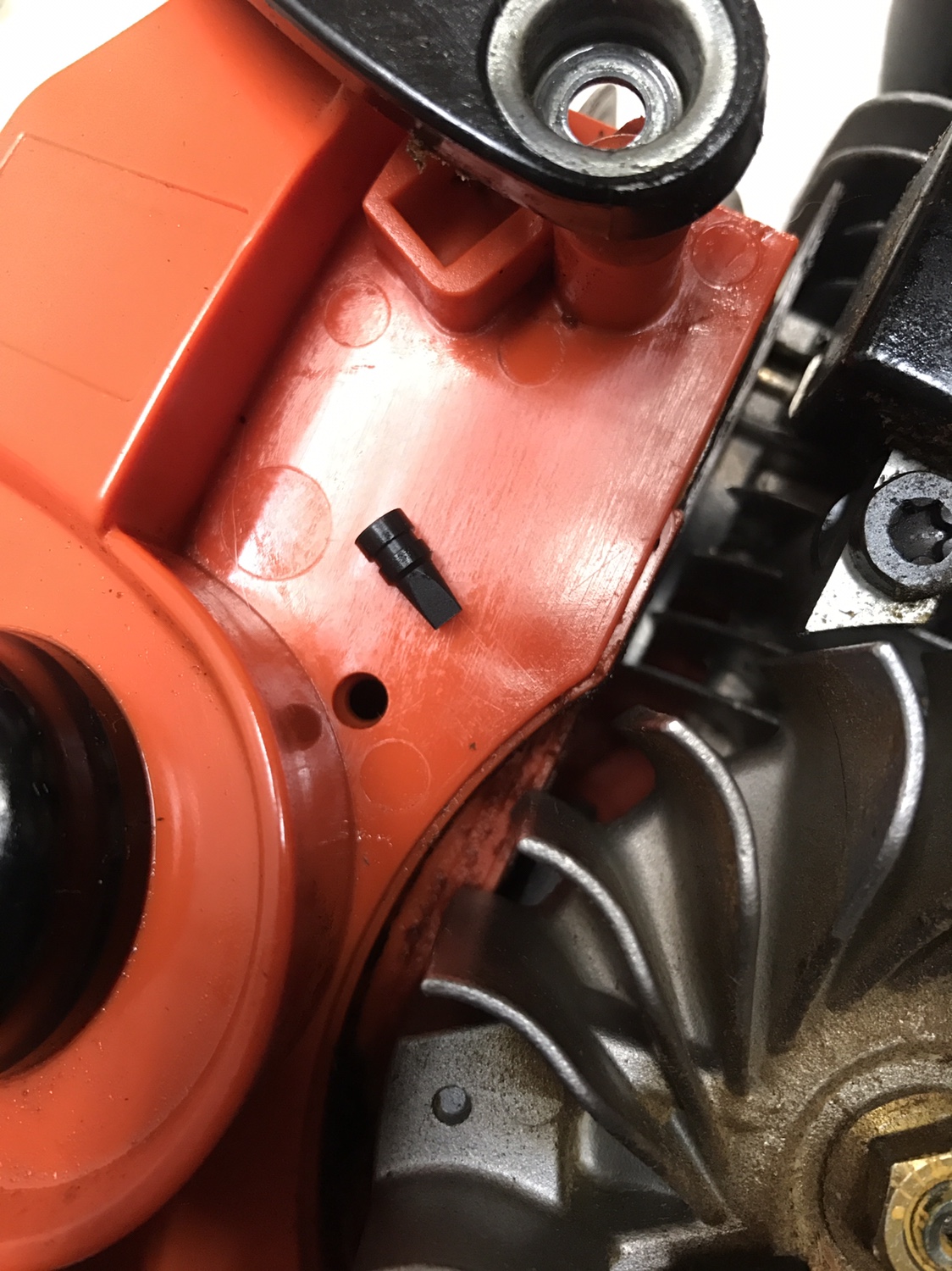

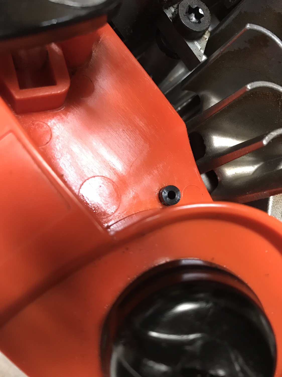

I believe so. I'm hoping that's the problem with the saw. Gonna order one and we shall see [emoji3]

Now the thought at hand is did the original vent fall out or was it ever installed :confundio1:
