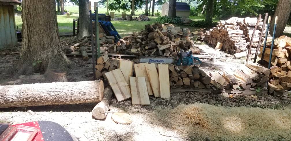

I’ll throw this question out there to the masses since this thread is about drying. I have a grain bin that is going to be open/freed up till October of 2020. The drying floor is in good shape & flat/level, I don’t plan on running the fan but I could to speed up drying, it would get a bit expensive running it for too long. With the vented floor & roof I am guessing that it will work well for drying some boards.
1.)Am I correct on thinking this?
2.)About how long does it take to dry Cherry that is/will be cut to 1-1/4” to 1-1/2”?
3.) Can I lay them flat & routinely flip them as seen in the photo?
4.) Or do I need to stack vertically for weight purposes?
The boards in my photo were the first ones I cut with my mill, test boards if you will. Mulberry & Cherry just wanted to try things out. I have plenty of paint for ends on the next ones.

best get them off the floor by using stickers under them (Metal and reactive consequences for the decking) and in my opinion the fan is irrelevant with a hind thought of refreshing (exchanging) the air. You have a HUMONGOUS floor area and could dry several or more thousand feet and then the fan would be a benefit.
