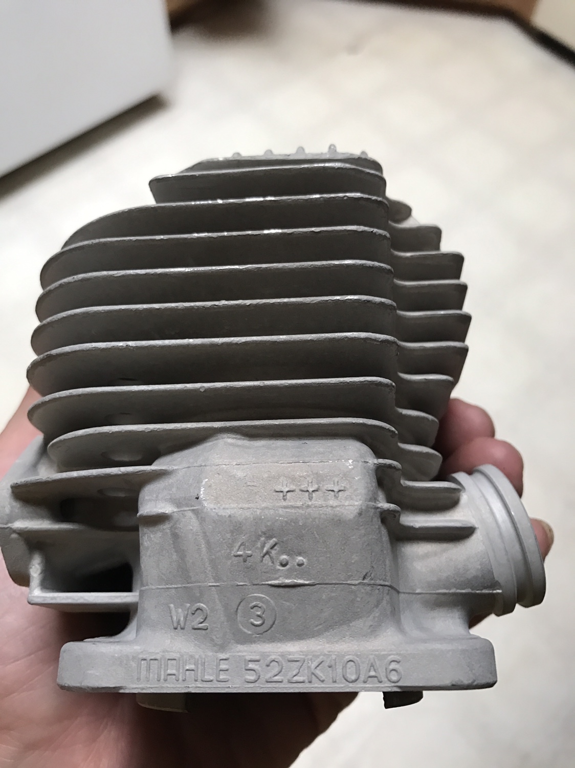

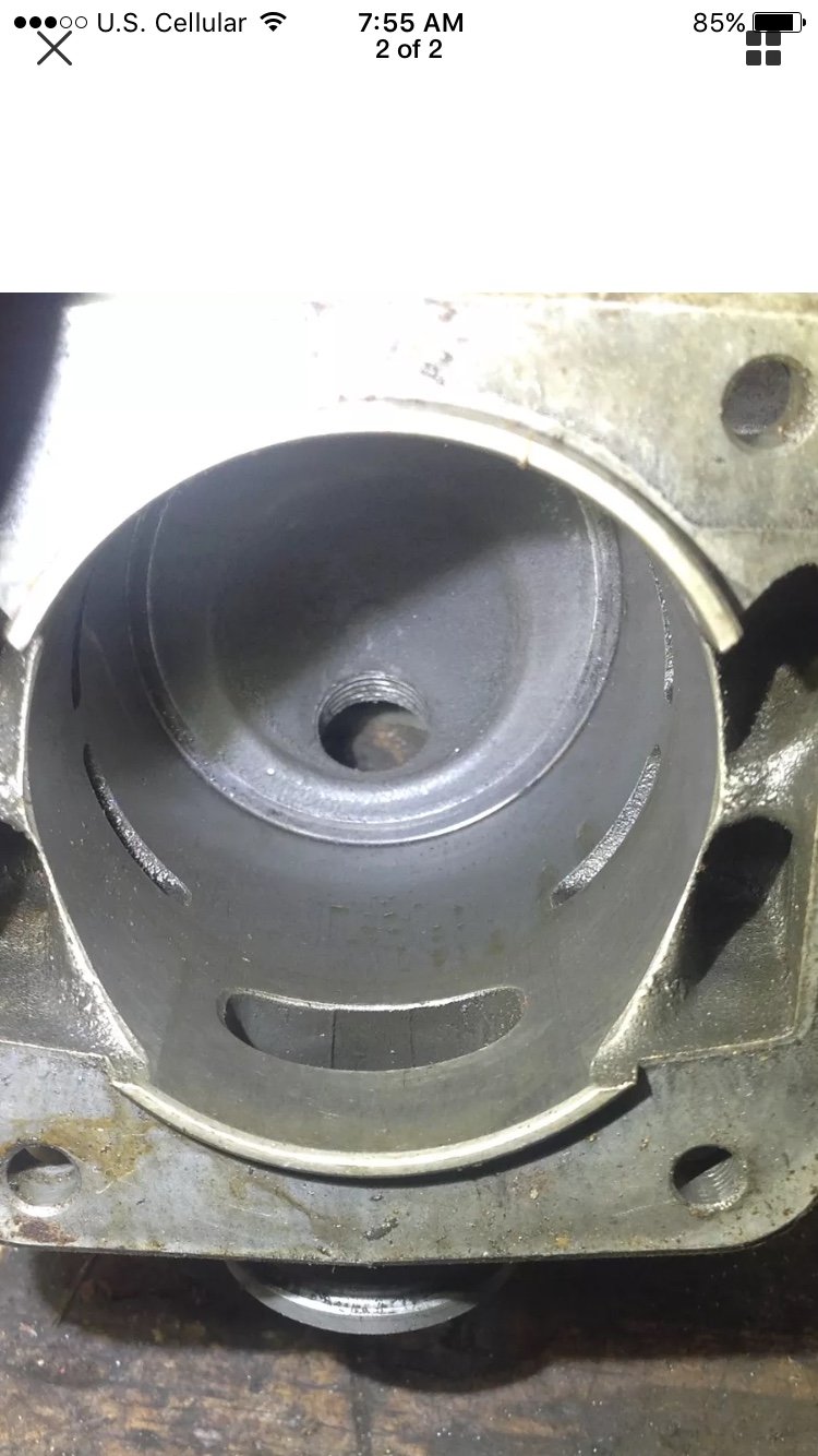

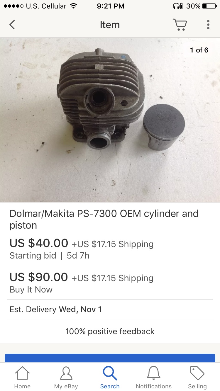

Is this anyone's here?
https://www.ebay.com/i/182839242070
11:22 PM
11,534
43,881
Second picture says Mahle 52ZK10 on the cylinder base.
I could be wrong but that indicates a 52mm cylinder bore which would make it a PS-7900 cylinder.
PS-7300 is 50mm, after market big bore is 54mm.
Piston is scored, would need a new piston kit.
I think the Buy Now price is too high in that ad.

Thanks for pointing that out, Wilhelm. It got me thinking, since that is also what my cylinder has written on it, so went ahead and measured the cylinder. It is indeed 50mm. Would have been nice if the eBay cylinder was 52mm! [emoji2]
I agree, the BIN price is too high. Gonna wait it out a few days and see if a minimum bid will do the trick.

@Skinnyminnie/ why dont you make offer on cylinder on ebay at 50 to 60 bucks on last day.wether its a 7300 or 7900 it will fit your saw wich im sure your aware of.wait till cylinder arrives mic.it.once you mic.it then get with nate. @fordf150 and order correct piston to match your cylinder.glws on ebay.thats your cheapest route and you aint buying chinese crap.

Currently the P/C is still at $40, with no bids and more than a day left on the auction. The belly button and I are still pondering making a bid. More than likely will, though.
I already have a piston handy, bought one when I got the saw, but didn't think I'd have to replace the cylinder this soon. So the hunt began.

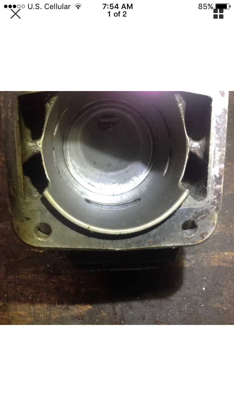

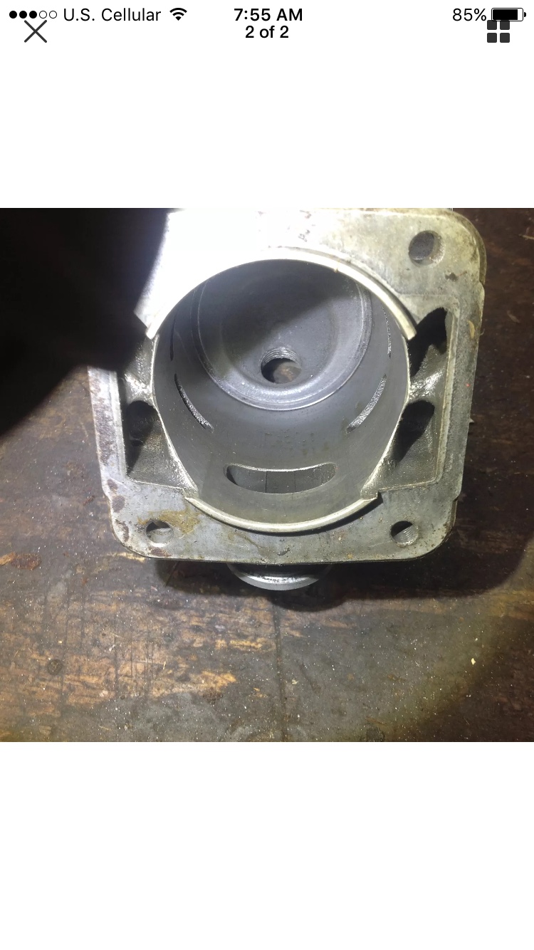

Here's a few more pics of the cylinder from eBay. Didn't see any scoring but looks like there's some pitting.

Looks good bud id. Jump on it.i just got a 6100 same thing needed p/c fairly new saw.i think imo its them thin 1 ring pistons

That may be a 52mm bore. I think the extensions are thicker on the 50mm.
