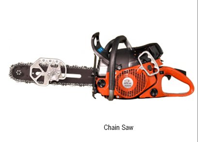

This it...?
Yes!
Sooooo sexy.
Some even have a flashlight mounted on them.
