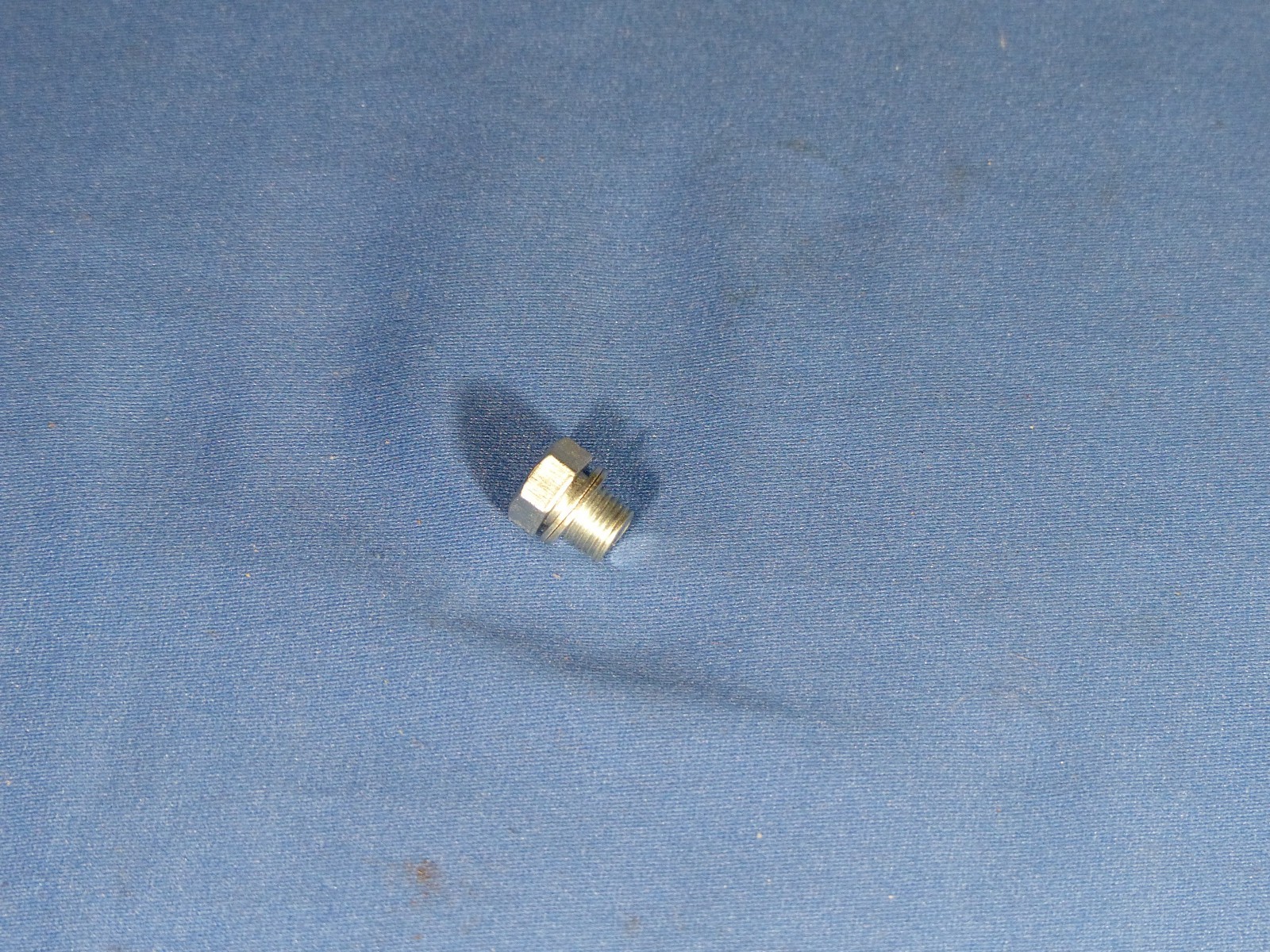

Thanks guys. I think I'll just get a plug like posted so I dont have any future issues. Is there an OEM version of that plug?
$5 or 6 at my dealer last time I bought one.

The OEM part number for the plug is 1122 025 2200, I use these plugs on all the decomp Stihls though they don`t list a plug for the 441 as such.
