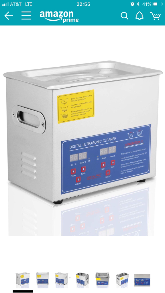

For Christmas I got a good CBN wheel that @Philbert had recommended. I know from being a machinist about keeping your wheels clean but I’m wondering does anyone give their chains a thorough cleaning before sharpening? I use a Q-tip to clean each cutter before sharpening but I’m considering an ultrasonic cleaner. Anybody do this or am I overthinking this.

I have a 3L I bought for $30..I’d like to have a larger one but mine works great. If you’re like me you’ll eventually throw everything in it, just be careful with solvents..some of them are harsh on aluminum and discolor it quickly. For chains I use purple power. Ive gotten advice on solvents from guys way smarter than I am.. rattler and drf256 specifically. I would tell you to buy as big as you can afford, I think a 10L will submerge a cylinder or flywheel easily (mine won’t) which is very very handy.

Not my favorite place but I looked at Harbor Freight and theirs didn’t impress me with the “quit working” reviews.

This is the one I have..bought it at a local ‘scratch and dent/open box’ discount type store. I was skeptical but have learned to Iike it a lot..especially for chains and carbs.
