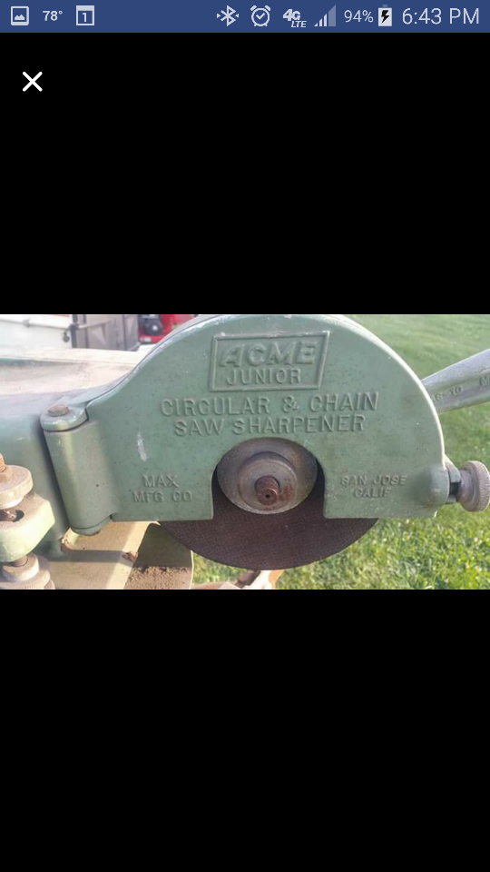

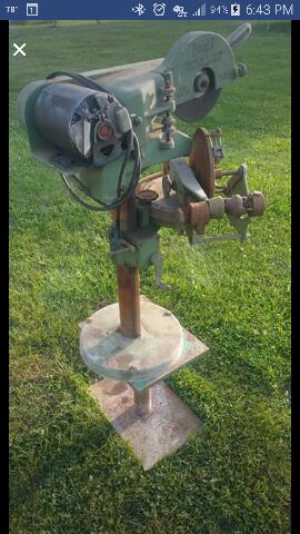

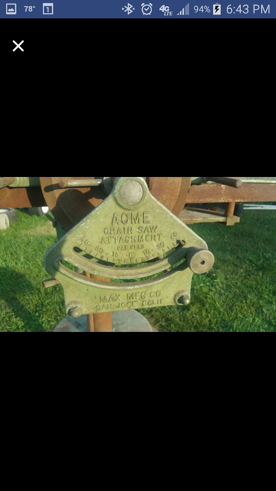

Anyone ever seen one of these before? It's for sale local.

Not seen that brand / model before. But if it works, and it's not too much money, . . . Go take a look!

Got a large wheel on it. I've never seen one like that either.

Wow, never seen one like it...

I was intrigued by it, but they want $350 for it. That is too much for my curiosity.

There is some old Foley sharpening equipment out there that might be a reasonable investment if you are setting up a small business, sharpening circular saws and other types of blades, etc. But if just sharpening saw chains, that money would be better spent on buying one of the current Oregon grinders new.
