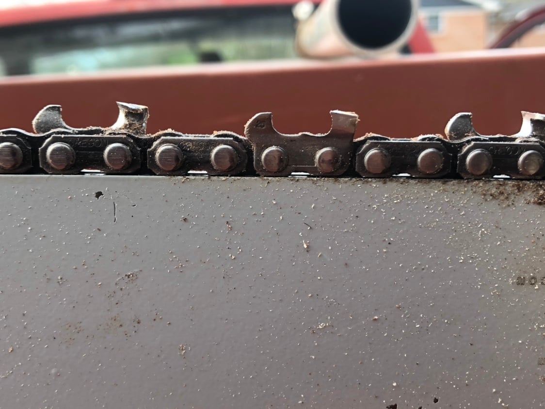

No i had use the same 5,2mm file for the complete chain.
And i use the nearly new bar that is on the pictures

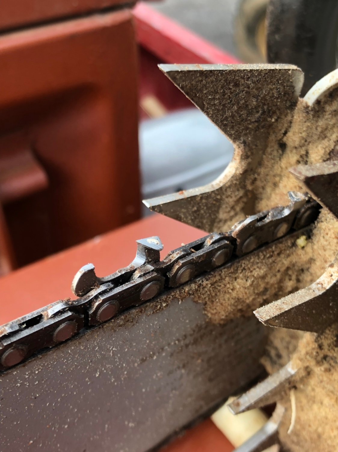

With the gullet removed all the way down to the tie strap as pictured, there's nothing left to support the file high enough to get an edge or shape the corner. 'Lifting' the file is pretty imprecise even with experienced freehand filers..., who probably wouldn't clear out the gullet to such an extreme depth resulting in so much hook in the first place. That's the op's primary problem. Probably been watchin' too much Buckin' Billy Ray and gettin' too much gullet. LOL Now as the cutters get shorter in length and also shorter in height, a free hand 7/32 or 13/64 file can then use the tie strap as reference to support it relative to the 80/20 ratio for its 20% or so contact above the tooth to again obtain a decent sharpening. But continuing to use a guide with a 7/32 or 13/64 file as the tooth gets shorter will end up resulting in back slope as more and more of the file diameter rises above the cutter. That's where using a smaller file can actually come into play for maintaining both acceptable shape and a nice edge on a dinky ass tooth.
Like others have mentioned, the Granberg is a great file guide for regaining shape and angles, and just as importantly, as a learning aid for gaining a better understanding of how it all ties together to help achieve the desired results when free hand filing. Grinders are great, but don't necessarily teach you much. Understanding a Granberg will certainly help make a lot more sense out of a grinder when you're faced with using one for the first time.
