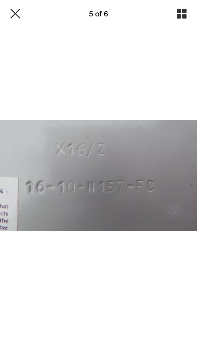

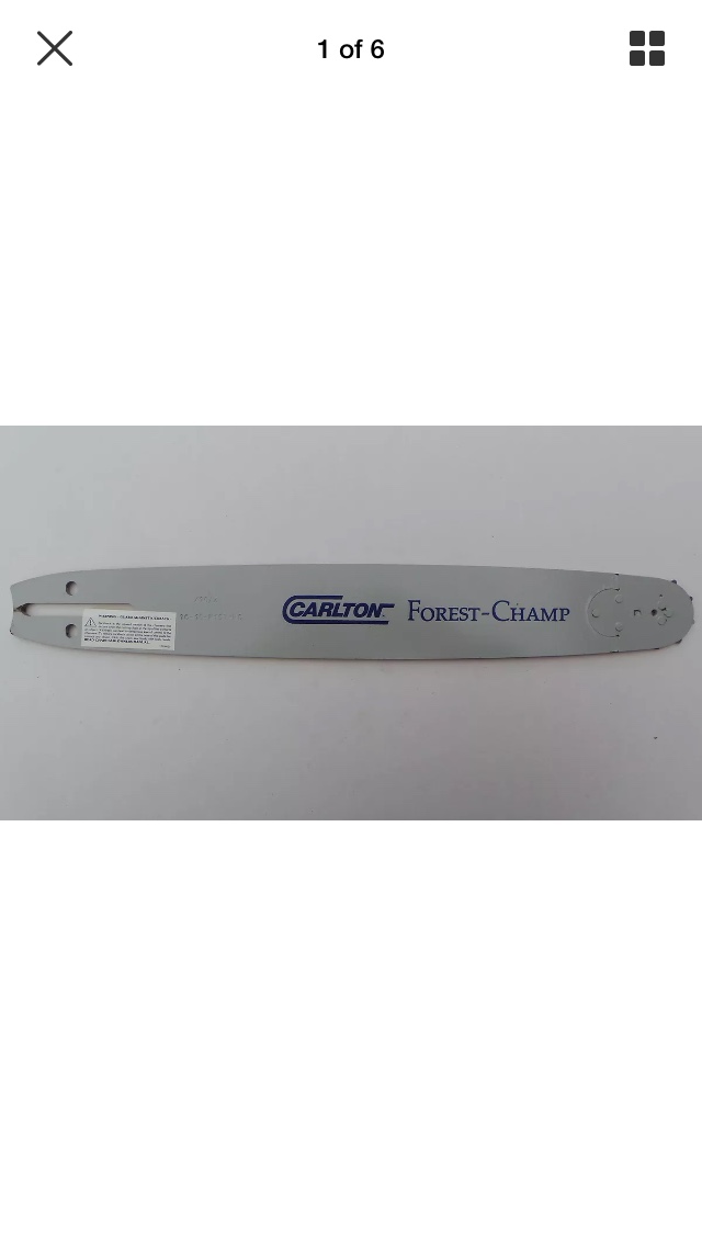

Anyone know if this bar will fit a husky small mount k095?
I am finding very little information.
It's a NOS bar.

That's a 3/8lp x .050 bar equivalent to an A041 mount. It differs from A095 in that it oils from the bar adjuster holes instead of a separate oil hole. The A mounts are narrower at the base than the K mounts for use with smaller rim sprockets. You could make it work with some drilling ...

Cheers guys. I think I'll give it a miss, can't be areas to demel a brand new bar. Yet I would gut a brand new muffler. Go figure.. Just was wanting a 16" bar for a 346xp. Guess I'll have to go either 18" or 15" Husqvarna oem. Thanks again!
