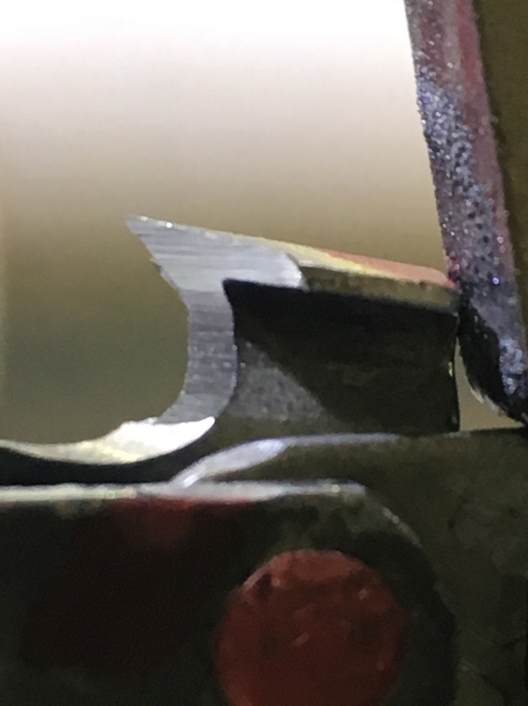

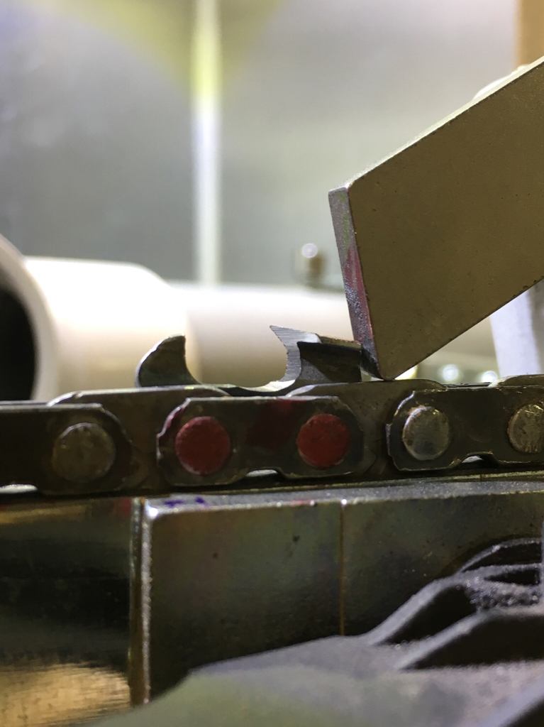

I know this isn’t carbide but try copy the contour
Hope it helps
I tell they guys that I sharpen for hand file all you want but something will get out of wack then bring them to me
