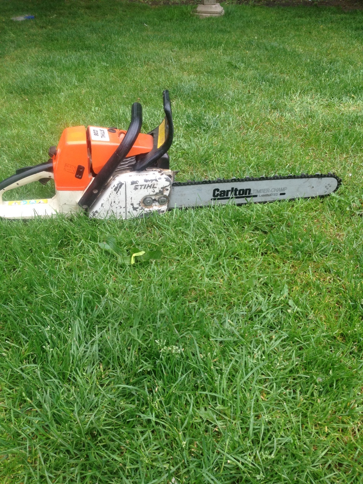

Here's the one I've just seen on ebay:
I can only see 036 on the cover, not 036av, or super etc.
The seller says the saw, has been looked after, but reckons "it doesn't like to start cold with the air filter cover on".
Come on guys, tell me about these saws, in particular the differences between the variants.

I'm also guessing that as this is an old model of Stihl then there's no chance of the one above being a chinese copy....the reason I ask is since that one above looks mighty clean, e.g. the tank handle does not look particularly weathered.

In regards to the pic above I don't believe that saw came from the factory as pictured. The decomp cylinder cover isn't correct for the style air cleaner cover. I have some experience with the Chinese cylinders and they do not perform anywhere near the original 036 OEM cylinders. These saws ported are very nice.
