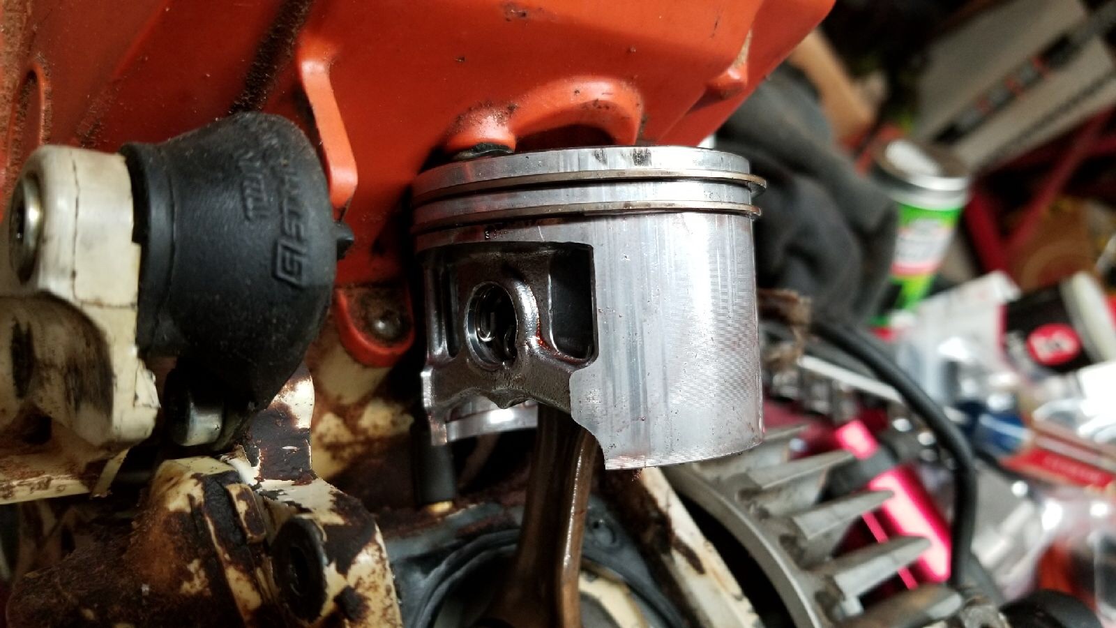

Once back at home I looked inside and the piston was scored big time. So I pulled the cylinder and there was no wrist pin bearing. None... but the entire bottom end was covered in fine black dust almost like graphite.
The cylinder looked fine.
Thinking back I seem to remember that there were also a few bits of ground metal and little globs in the case.
It turns out that he had used an aftermarket piston pin bearing and it had disintegrated.
I remember flushing the case out with fuel many times and straining through cloth till it was clean, but I honestly don't remember if I split the case and changed the bearings or not.
At the time there was a thread and guys were going both ways on how to deal with it.
I figured "*s-word-happens" and I replaced with a new OEM piston and lightly cleaned the cylinder even though it was virtually unmarked. I re-assembled the saw and ran it in wood, all seemed good. I think it went to several GTG with me since and has run maybe another tank or two of gas since the new piston and OEM piston bearing I installed.

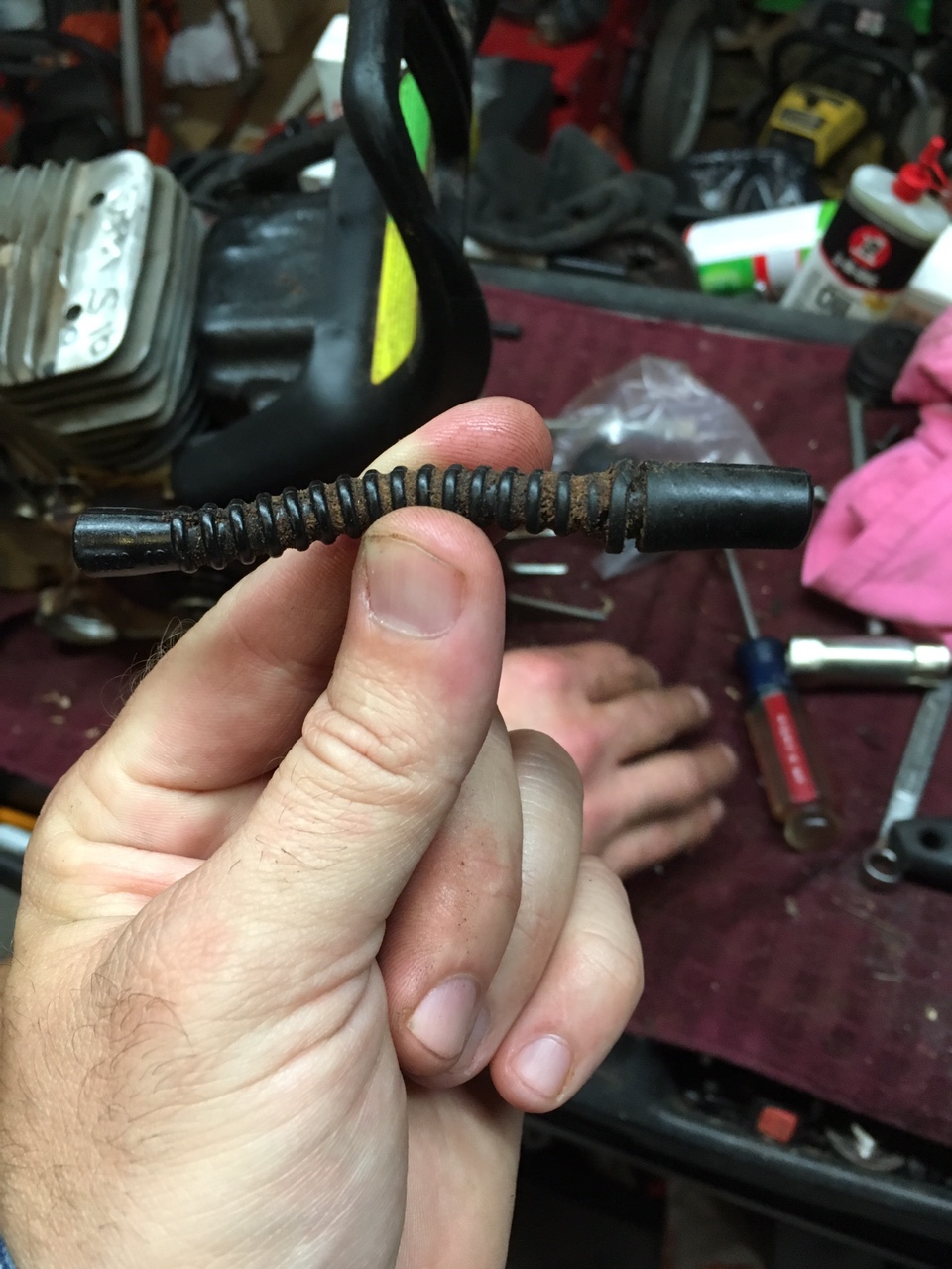

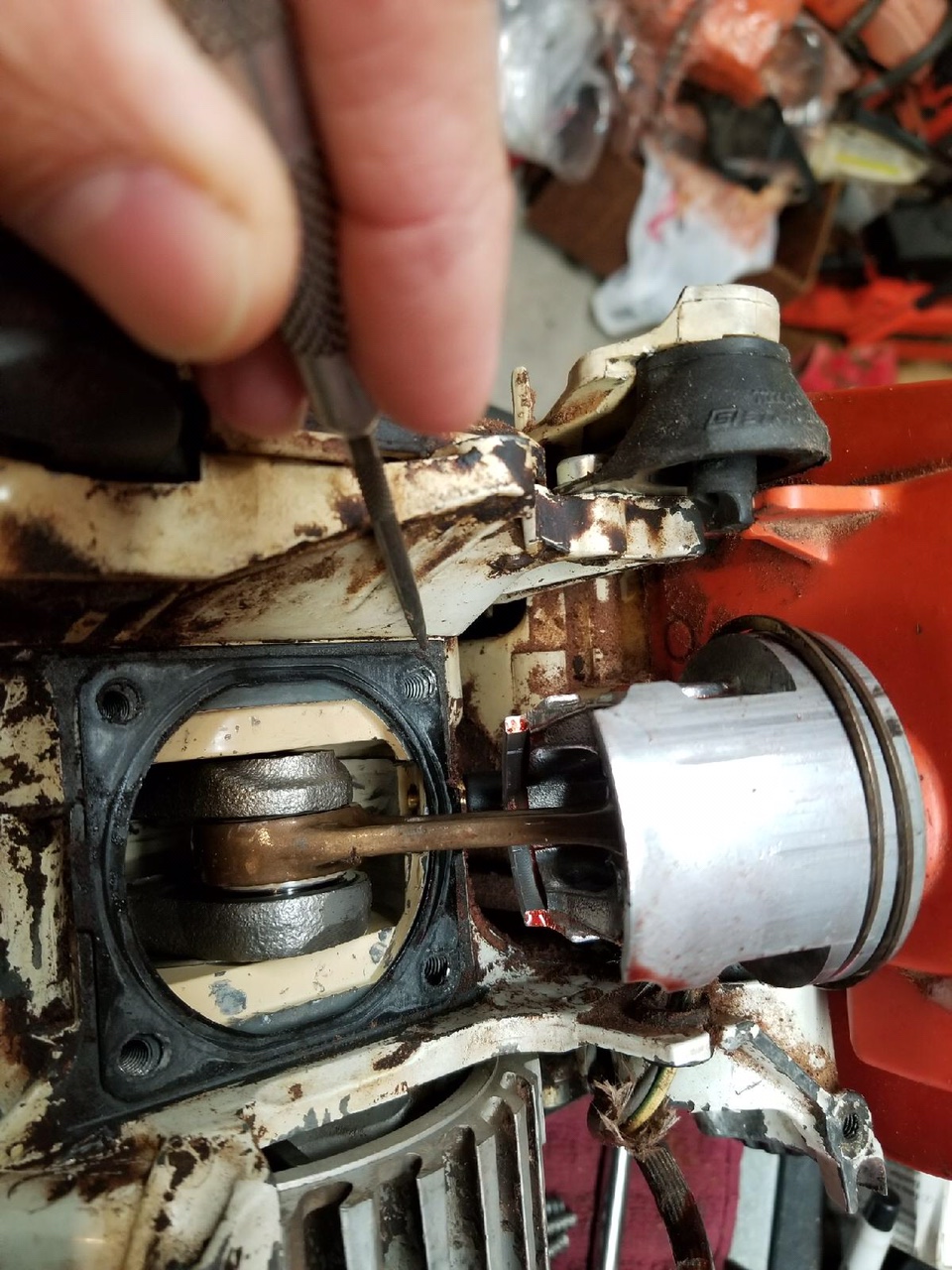

I noticed a broken off muffler bolt, hmmm, I never looked, might have broken off after i got it back. Missing a top cover screw, hole is stripped, might have been like that when i sent it.
I pulled the muffler and saw vertical marks, not deep and pretty faint but not right.
So off comes the cylinder for further inspection......Oh, wait

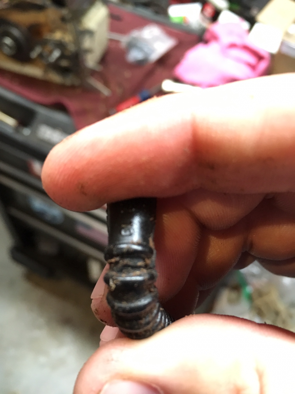

One of the cylinder bolts is not like the others, Fuggin Sesame street in here.
The trigger clutch corner bolt appears to be a larger hex head bolt and to be completely rounded off in the head of the bolt. Oh Joy is me, I couldn't be any happier.
It was hard to see and dang near impossible to photograph.
I am pretty sure that if I take off the tank I will be able to get on it with tight reach channel locks and get it out, but what a pain in the...

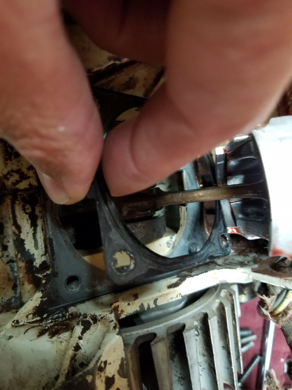

I pulled the muffler ahead of him coming over to get it and the piston and cylinder are flawless. We ran it in wood before the trade and he has run it in cants and even in big wood since then.
I will add pictures and I invite the new owner to talk about the saw as well.

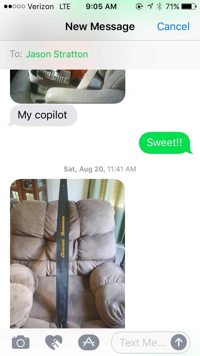

I also purchased a new Cannon 50" .404" Stihl Large Mount bar, & had Piltz send it directly to JMS Inc, to use for Testing, because I wanted a Hoss, & the biggest bar JMS had was a 32".

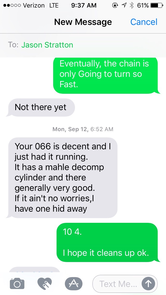

So then he starts porting my original cylinder, you know, the 1st generation decomp Mahle that everybody says are the best 1122 cylinders.
He gets really close to being done, & "the playing starts flaking." "He would run it on a Saw he had, but not a customers saw."
He had a RL 066 cylinder, & agreed to supply if we traded for the MagII cylinder. (Red Flag)

He kept forgetting to send my $500 worth of Bars & Chains back for almost 2 months.
I finally get to run the 066 & it is strong, but the brake doesn't disengage with the wrap Handle JMS says would work.
He tells me I've got to have a different flag- $50.00 later it works.
Oh, one of the Brake flag screw holes was stripped, & I had to have that fixed as I didn't have time to fool with it.
Flash forward, & I decide to sell the Saw to buy a 661 from another trusted Member.

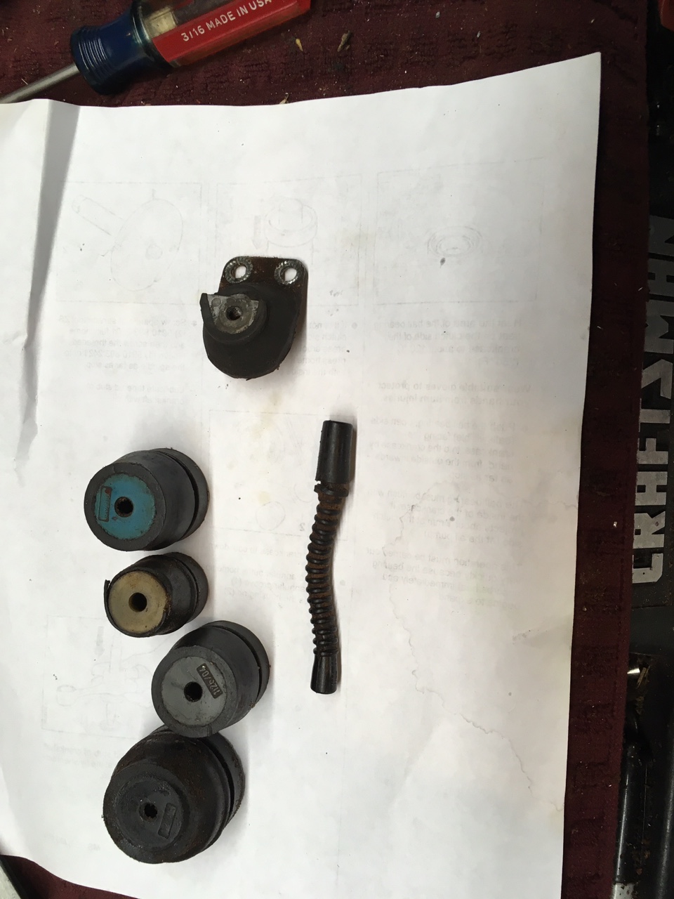

The 066 moves around like a 1970's Buick with worn to death shocks, so I buy $75 worth of AVs.
During the replacement of the AVs, it's realized the Impulse line is harder that $9.00 worth of Jaw Breakers, & it has a crack in it.
A new one is installed, along with all the AVs, & then Pressure & Vac tested.
That was a Miserable Failure: leaking like a sieve.
Cylinder is removed & the Belt Sander Bandit has struck again.
I text Jason, tell him what's going on, & he initially says that cylinder could be 0.100" out of level, side to side, & still pass a pressure test: he hints that I'm a part of some agenda, but he rolls that back a bit.
I tell him I had to swap out a lot of stuff we agreed he would fix if needed, & he states I sent him a non-running Saw, & that he ported it, he didn't build it.
I then shared screen shots of our text,( I've never actually talked to him to this day), and he sees that he ran the saw in the state my Southern friend sent him.
He looks at the pictures more & admits he made a mistake by " not clearance for the case on the FW front corner. His Fault, a 30 second fix, & he apologizes."
He ask me what I want to do to fix, & I tell him I want a new cylinder, or my original cylinder, & $500.
We go back & forth, & he promises to do just that.
