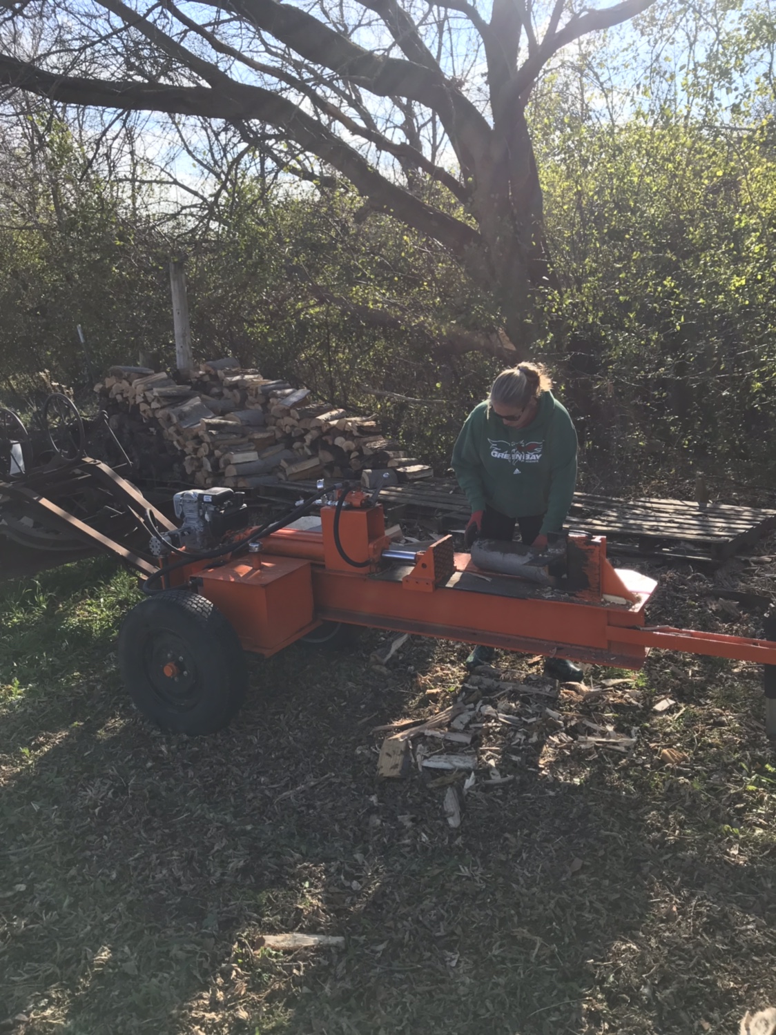

here’s a pic of the splitter. This year I was fortunate to get a few loads of oak and ash and beech. But I can foresee a fair amount on box elder in my future.

I put a Honda gx160 (5hp) and a 11gpm pump I had laying around. Just to get the project together. I do have gx390 in the shop. Just gotta get a 22gpm for it. It has a 4x24” ram and a small wedge designed wedge. Not exactly knife like and not exactly a super flair wedge either. I did build/modify a 4 way to slip on. It not being adjustable, works better with two people. One to hold and square up the rounds, and one to pull the leaver.

DIY is about making do with what you've got or can afford. Might have also been a test run at under full throttle.
