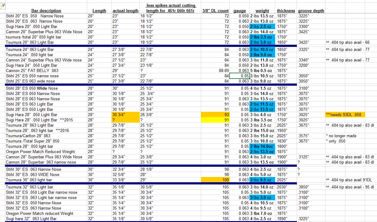

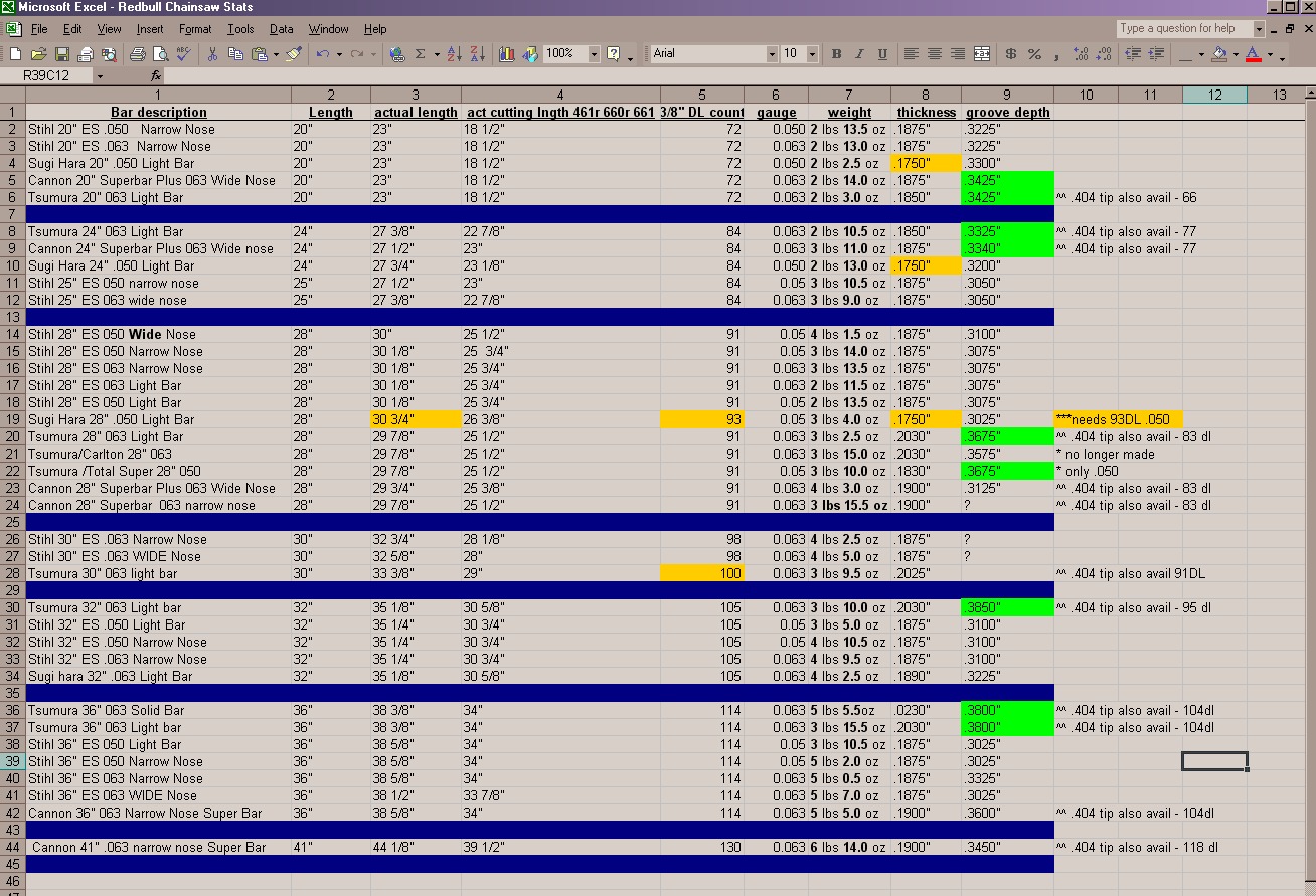

RedBull has a great collection of bar stats I was recently viewing. Here's the list he made:

thanks everyone. Redbull pm'd me his list and thanks again redbull. His list is so detailed and just cad awesome. If you've seen it it sure looks like a tsumara is the way to go if you're looking for that of bar.

If I recall, Redbull rated the Stihl light best but spendy so Tsumura Light and Tough better option. I have 20, 24 and 36. Not heavy use but super so far. The longer bars make bigger difference.
