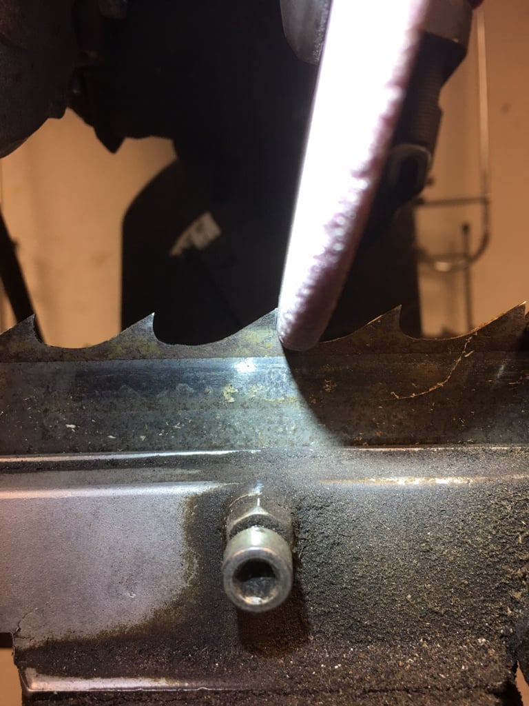

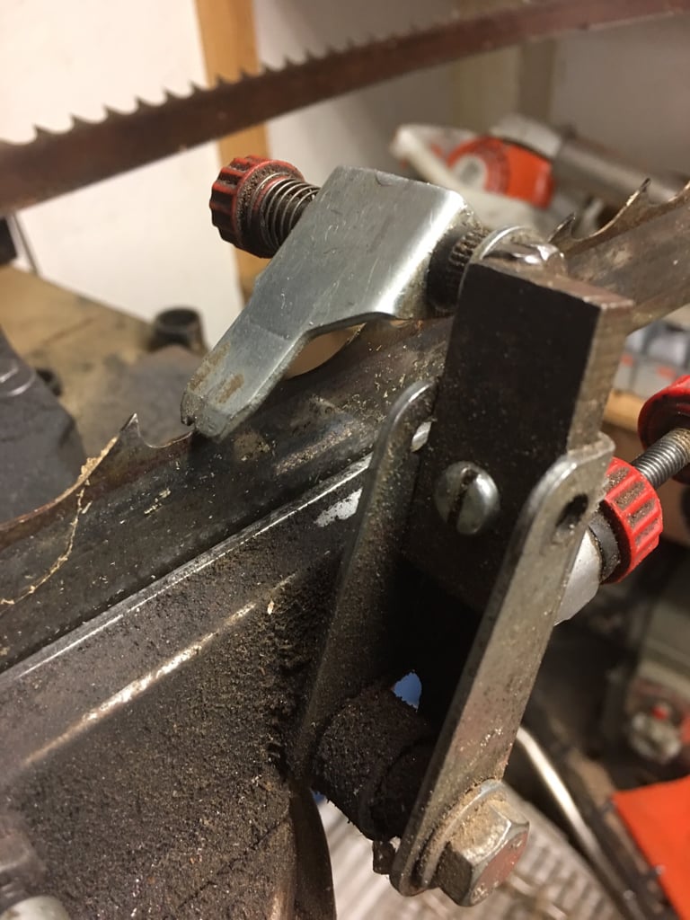

It's basically just a riser for the blade stop. The stop has a groove notched in it for the blade. You have to flip the band inside out and depending on the wear of the blade I'll touch up the back of the teeth gently using a cut off disc in a dremel. Whole process takes less than 15 min and costs almost nothing. Cut quality is as good as a new blade after sharpening. I also have a tooth setter but rarely use it.

I do not know how much you can actually add to the set after sharpening on narrow kerf blades. The teeth are hardened to about the same or harder than a file. As such they are brittle. You can see the heat treat line in one of the pics, it runs slightly below the gullet bottom.
