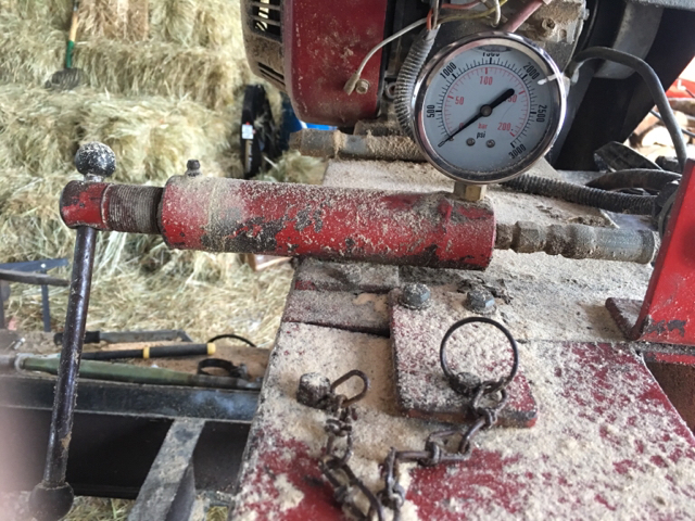

I use the flutter method on my shop bandsaw but my mill came with the gauge and it works surprisingly well.
Here's a photo of mine.
