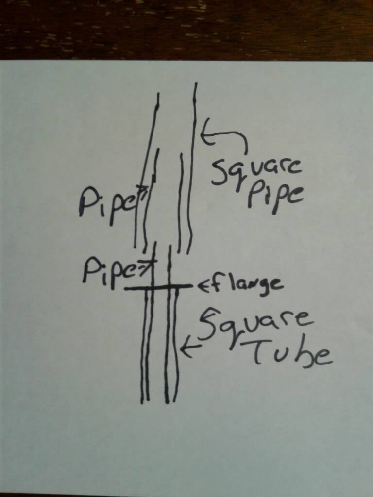

I was thinking of cutting the small tube in half. Cut the square tubeing for the boom. Weld a foot on each end of square where i cut. Then weld the big tube down on the smaller one wagon side. Weld The smaller one on top and will slide in and be able to pivot. This sounds better in my head then on paper lok.
What are talking about with a flange?

Sounds like me and my son inlaw was talking about doing to his so he could swing it around to the bed of the truck, his mounts into his trailer hitch. Flange I'm talking about would be a round flat metal welded on the bottom half at the top so the top part would sit on top of it, and would pivot on top of it without binding, a little grease between the two would help making it easier to swing around.

Here's my doodling, not the greatest, this is what we're thinking about doing.
