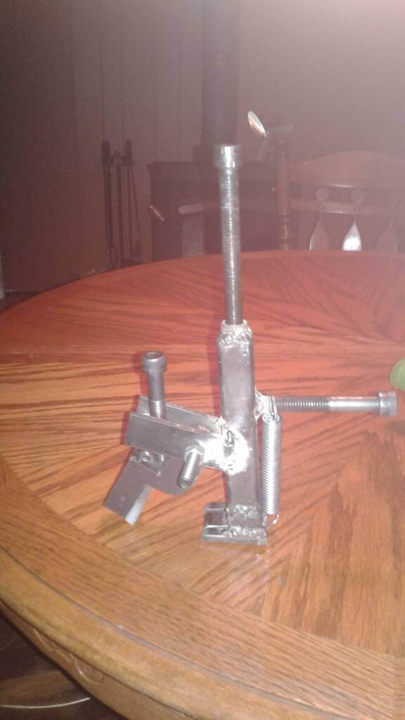

There a *b-word to break down.we used to put a 2/6 on rim and dr.up it with a cehicle to break em down.then use tire lube from a comm.tire store whwn airing back up to seat bead.and rake off as it filked back up.made easier for next tire break down too.
At first i tried the dride.on with 2x6. The i built a tire bead breaker. Then tried the high lift jack under the bumper of rv. Then i looked to you tube and discovered the bead buster. Built one and thats the beast that got it off. Checknthem out on youtube they work ausome.
