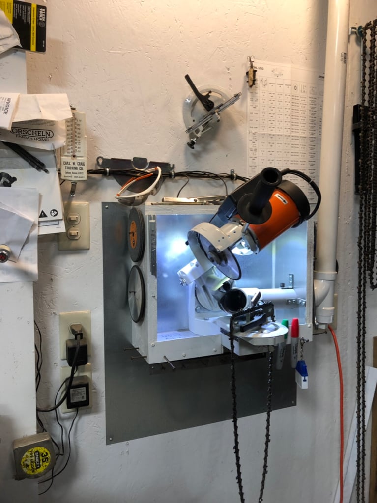

Too bad you are that far away
I like to sharpen carbides

Doesnt the usps still deliver to your neck of the woods? Small flat rate boxes could make that happen just fine. I cut ski trails so stumps have to be very low to flush... so hard on regular chains, which I hand file in the field till the cows come home...
Been thinking about taking the carbide plunge in a big way with a bunch of loops...
PM sent
