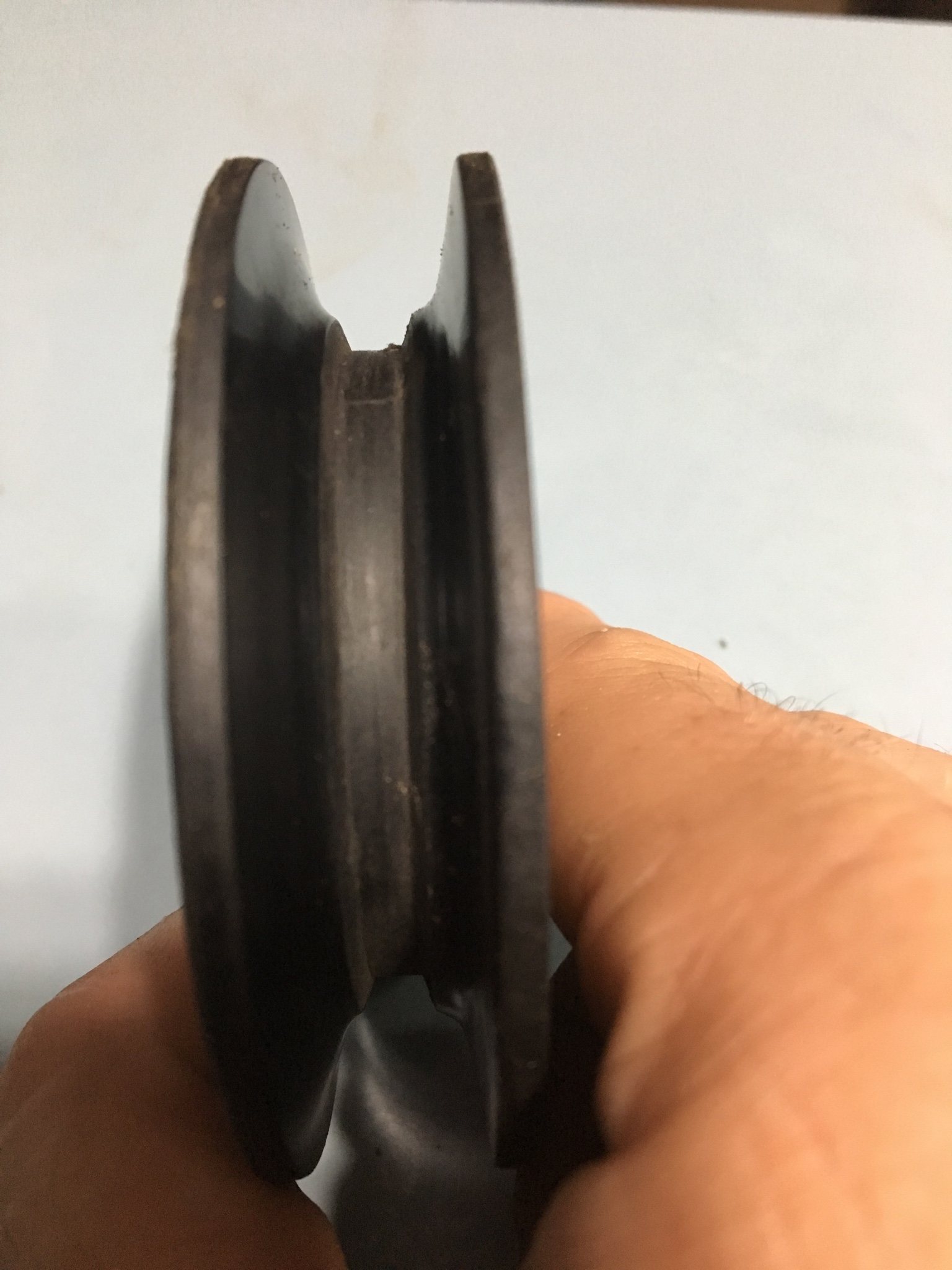

Ok just checked the pulleys. It felt like the idler pulley 690410MA wasn’t smooth on the surface where the belt rides, possible belt wearing divot in to the pulley over time causing less tension?

Here it is. Thoughts?

That pulley is worn out.is it an idler or engine pulley? On slip belt drive systems the engine pulley is prone to wear out just from use. The trans pulley almost never wears out. The belt is designed to wedge in the pulley groove. When pulley wears it take more tension to make it grip. Clutching belts are different than automotive v belts in that they slip some when engaging vs. Grabbing. This just wears on the engine drive pulley

That’s the idler pully. The engine pully is metal and appears to be in good condition

I thought it was worn but the Wear indentions are so uniform all the way around it had me second guessing myself
