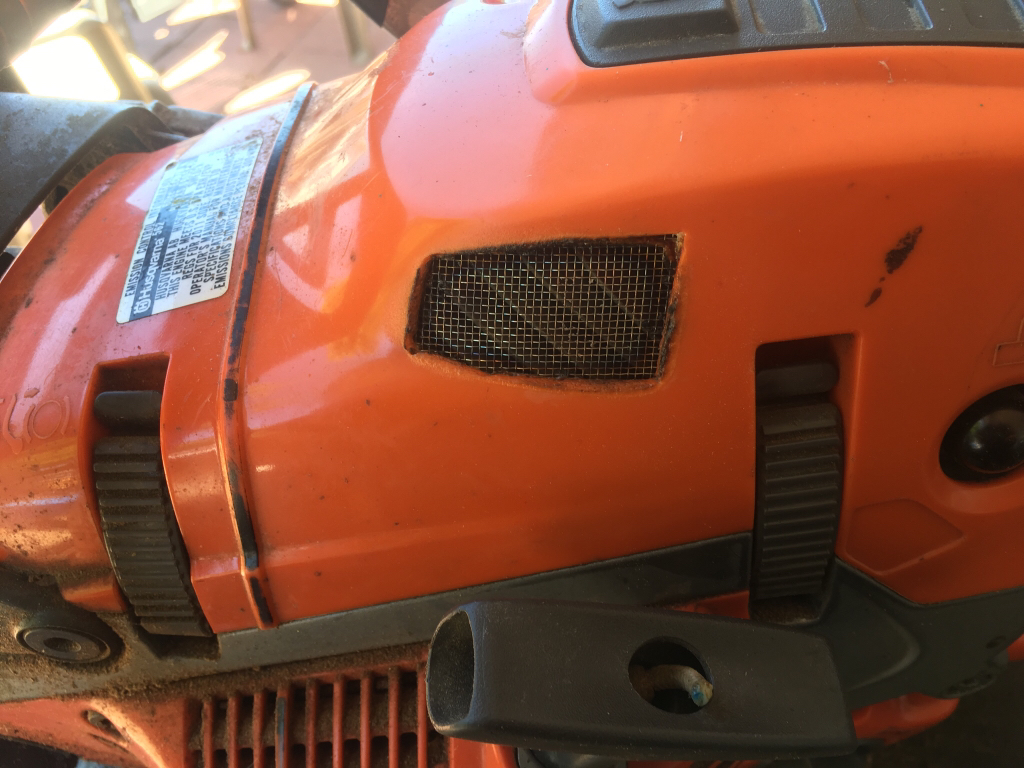

This past weekend put quite a bit of time on my Mastermind 562. During this wood cutting expedition encountered several hot start issues as many of you have encountered. I know there's quite a few threads on this topic. The new design incorporates vents to help prevent the heat soak of the carb. Decided to try this modification to the hood to provide better airflow. I based this modification by looking at the inside of the hood and noticing The air flow pattern was traced by Saw dust. I then traced this with a sharpie marker and then cut it out with a Dremel. Then I glued spark arrestor screen on the inside. Have any of you fellas tried something similar for your 562's?
So far I'm getting good results but yet to run long term after this mod. I will report back if there are any problems. I've got some hot weather coming and hope to run this saw-mod though its paces. I will report back what I find, good or bad.
Here's a couple pics:

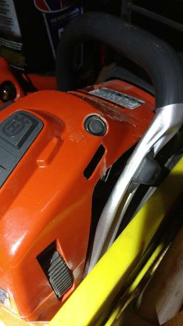

Hole should be on the other side of the saw like factory one

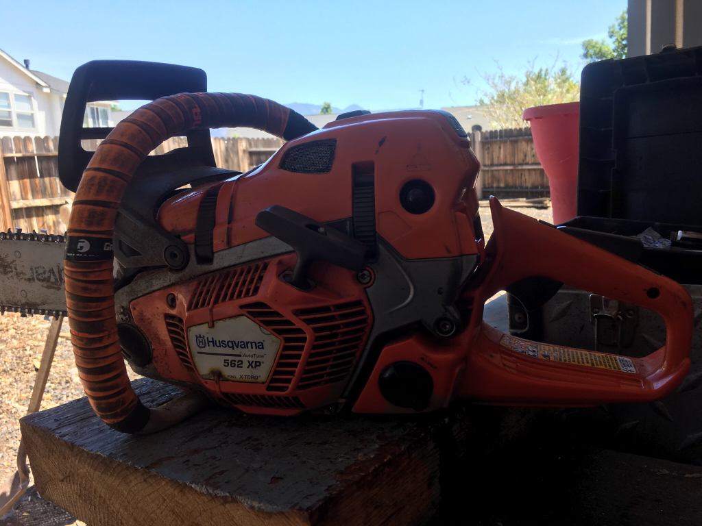

here's what i did prior to the new top cover improvement. it helped. i'm with old guy.View attachment 72536
Looks real nice. What did your new cover cost you? also have you had any hot restart issues since installing the new cover?
I'll Probably just run it like it is for a while until I get a new top cover like yourself.

I did it to my 550 which has never given any hot start issues.
new cover $28.00....no hot start issues
