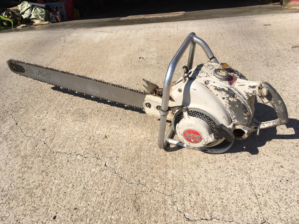

3 rivets measure 1-1/4”, so I’m assuming this is 5/8 pitch?
Remington chain, .058 gauge.
Looks like 3 rivets is approx 7/8 to me (18 to 18-7/8). That puts it closer to .404, no?

It’s bigger than .404. I compared it to my Oregon pitch gauge, held up a loop of known .404, and this is definitely bigger.
It’s on this:

7/16” x .058” is very common on the large old Remingtons.
Bantam types and Logmasters.
That makes sense. I'm betting that's what I have. I brain farted last night, and measured 3 spaces, instead of 3 rivets. d'oh! Can't even blame the barley pop, as I had just cracked the first Genny.
So what size file would I need to touch it up?

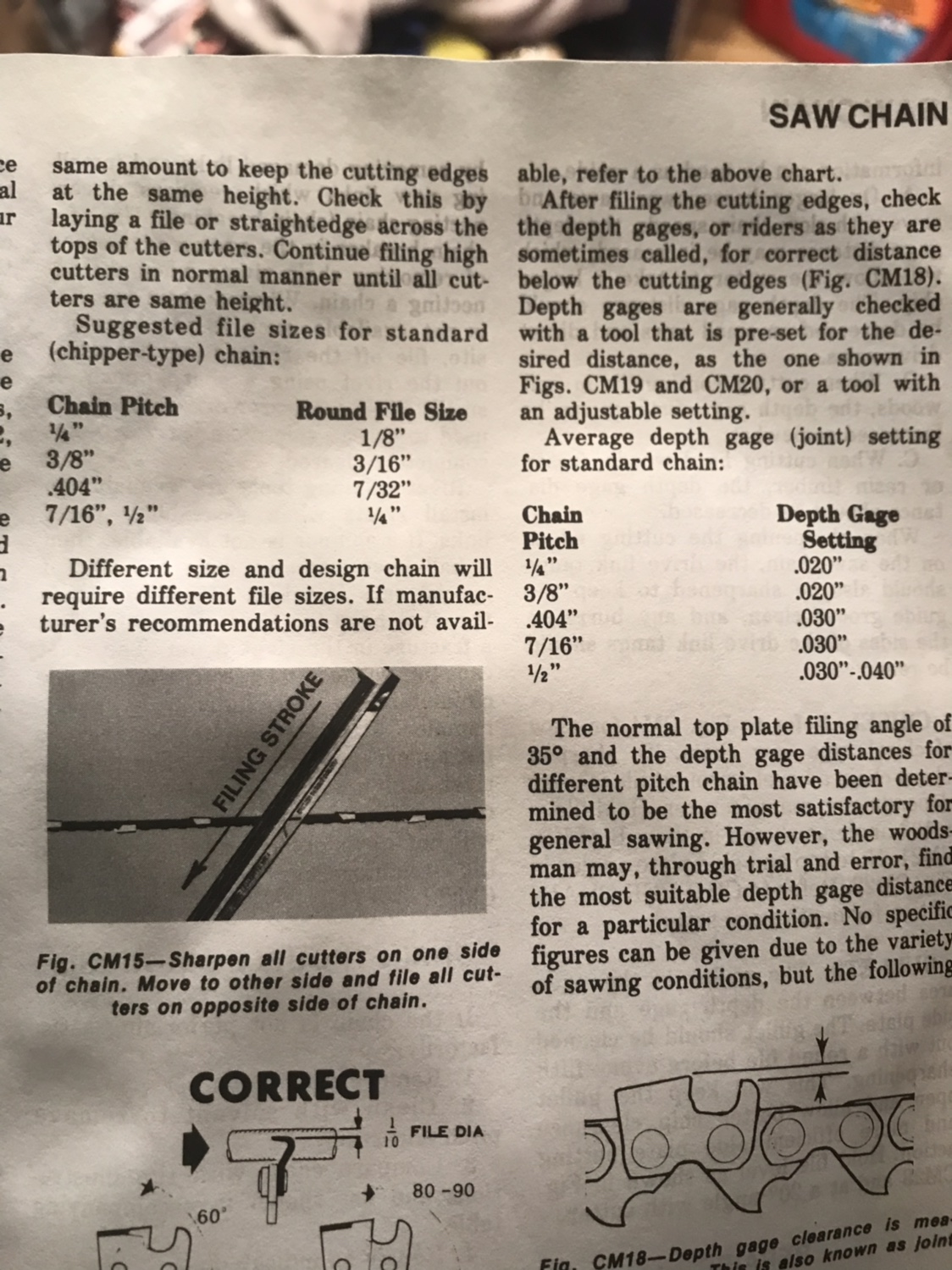

If you can read this. It does list file size and depth gauge.

Thanks. Looks like 1/4” file and .030 rakers to start. That’s a big bite.
The motor doesn’t have the speed. It makes up for it with a bigger bite and low end torque.
