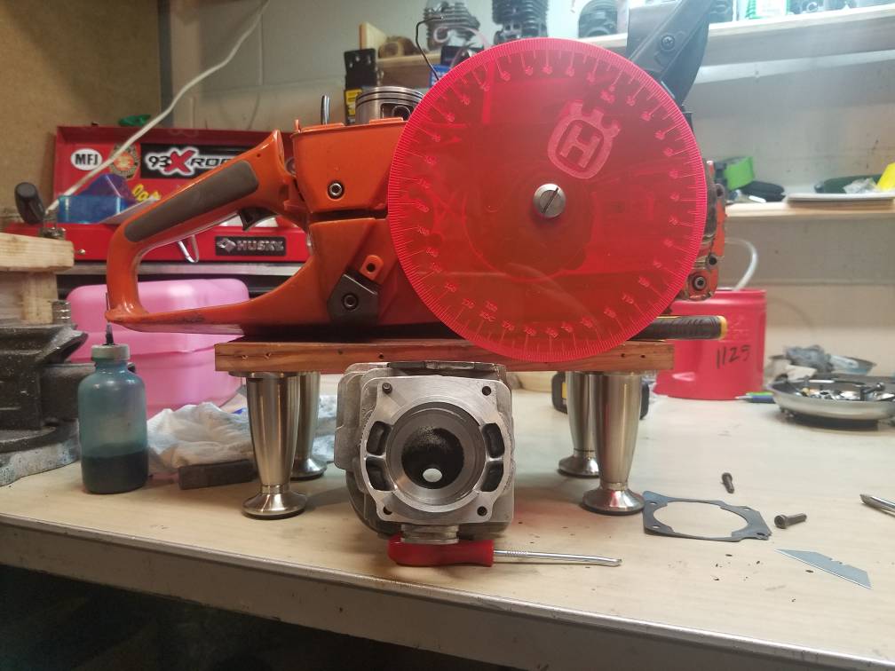

Mike installed new bearings in it and ran out of time before he had to head overseas. I'm finishing up the complete rebuild for him. Installing a new Meteor piston today. Let's see what it looks like when it's all together and we'll talk
Sir yes sir. Take your time..I just realized I’m down to only three ported saws in that size range...might need a Christmas present, especially a sausage finger model

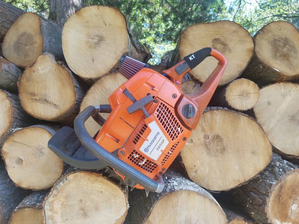

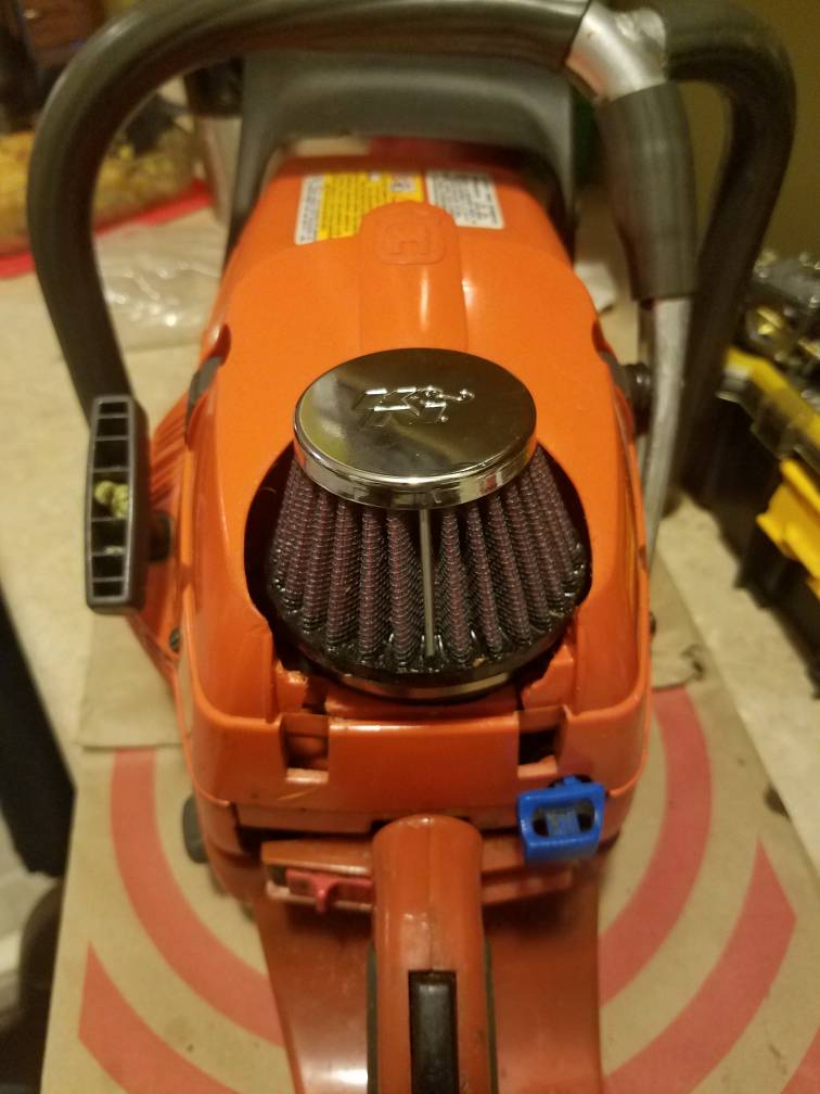

Here is the last 385 I built. I ported it after being decked and band cut. Ran strong. Its wearing one of my vstacks and a k&n. I sold this one to a guy in Connecticut. Hes very happy with it. Guess I'll have to build another one...hehe.
