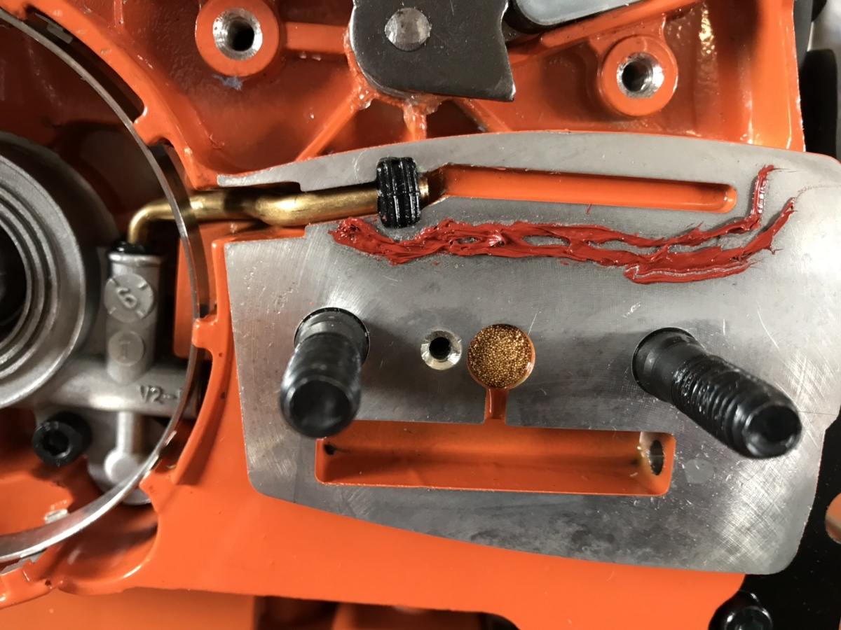

Removed the flywheel. Was done with some hammer beats. Not really complicated.
One of the four screws was not so tight like the others. Retighted all of them a bit carefully. We‘ll see. [emoji51] From the outside the gasket is looking normal and everything seems tight together. Strange. I lifted the other side a bit during the saw standing on the bench. Maybe the oil runs on the lowest point towards the gasket. It’s not standing balanced due to the spike.
I recognized that the oiler screw is also leaking a bit. Should I also ignore this or can this be fixed?
Locktite the fasteners while apart.
Run the saw a bit maybe the oiler screw will sort itself out.

Did tightening fix it?
Can’t answer it. Up to now tank is empty because I put in a new oil line to the pump. Maybe I’m lucky and the oil all came from the outside and not the inside. Will report tomorrow wenn all is put back together.
Oiltube „glued“ in with a small amount of Dirko HT. No more oil leaking. But I’m afraid that the crank gasket has a problem. There’s a tiny amount of oil coming out on both sides. Not from the outer case running towards the gasket.
That’s not worth splitting the case I think. Therefore it stays like it is. I’ll try to remove the oil every time I don’t use it. So no Problem. The oiltank vent is also leaking a bit when moving to the side. That’s normal I guess.
I also put a small amount of Dirko near the oil whole to prevent it from going through the inside instead of to the bar. Maybe it helps a bit.
