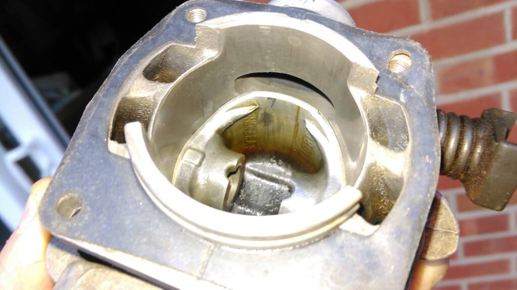

So check out this picture, it is just as the upper ports are fully closed. Is this the point where the Intake should be fully open? As it starts to compress the crank case mix up through the ports? If so, should the skirt be trimmed back to give optimum intake flow and volume? It currently covers about 1/6th of the intake... Or am I getting this all wrong?

That would be the same as grinding the floor lower on the cylinder intake. It would change your intake timing by about a good ten degrees or more.

Yep thought I was missing something and being dumb. Just looked strange to me. Just gonna run this stock, minus base gasket and start looking for the 272 parts for my hybrid that you talked me through..
