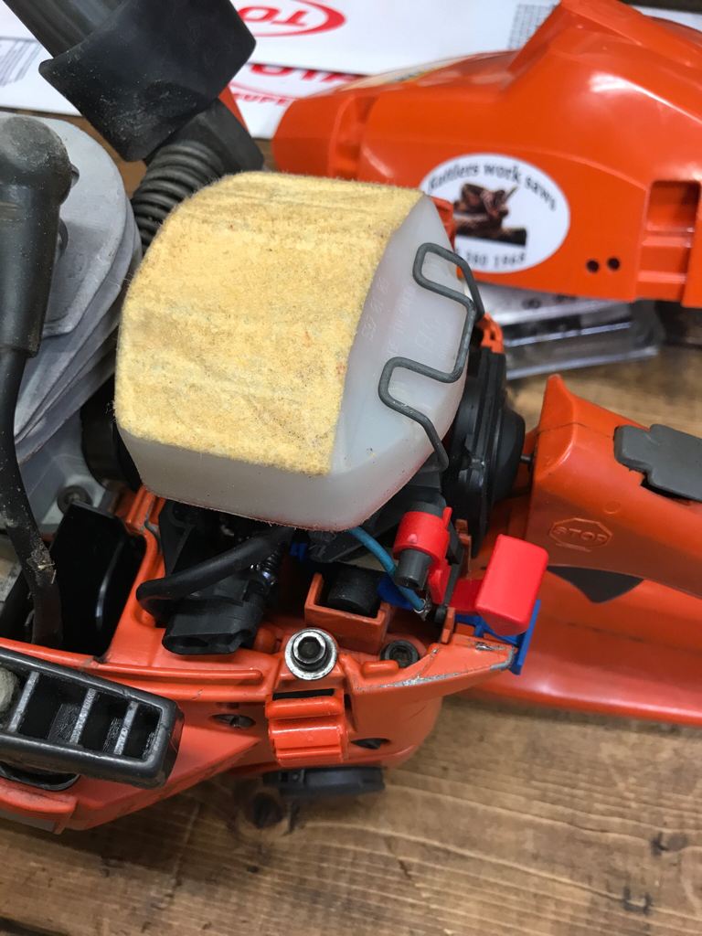

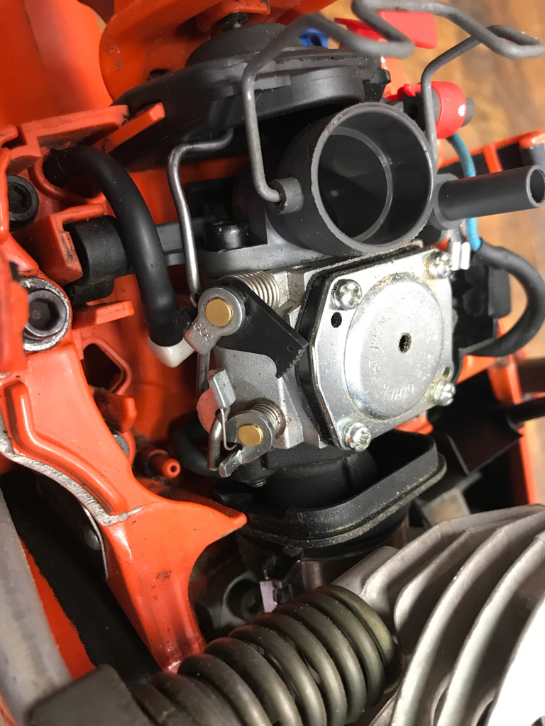

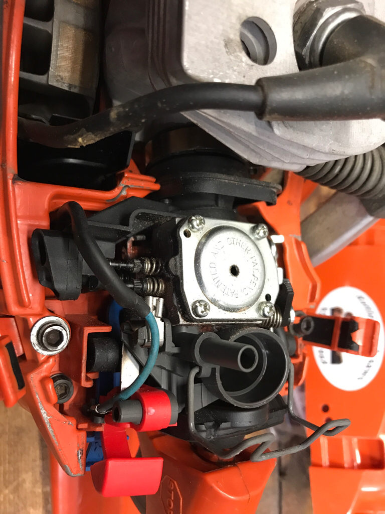

I was wondering if anybody had any good pics of how to properly install the 357 carb and intake on a 346. Also is there a screw type clamp that will fit the 346boot?

Mine has the full 357 intake tract..boot, filter, etc. Some have had (small) clearance issues with the linkage in the carb box floor I hear. @rattler did mine awhile back and as far as I know and see it’s a straight bolt on. I think some have used the 346 boot and filter with no issues but I think the larger bore 357 is preferable
