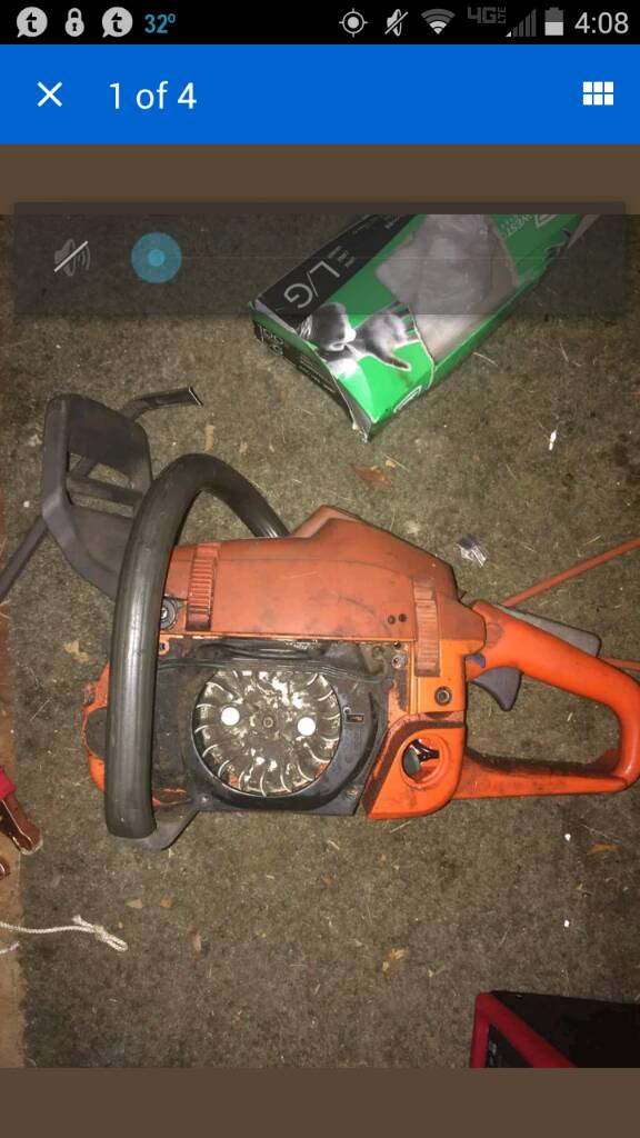

That one doesn't have a 346 cylinder on it. Look below the decomp button. It has a removable plate. Somebody's not getting a true 346.

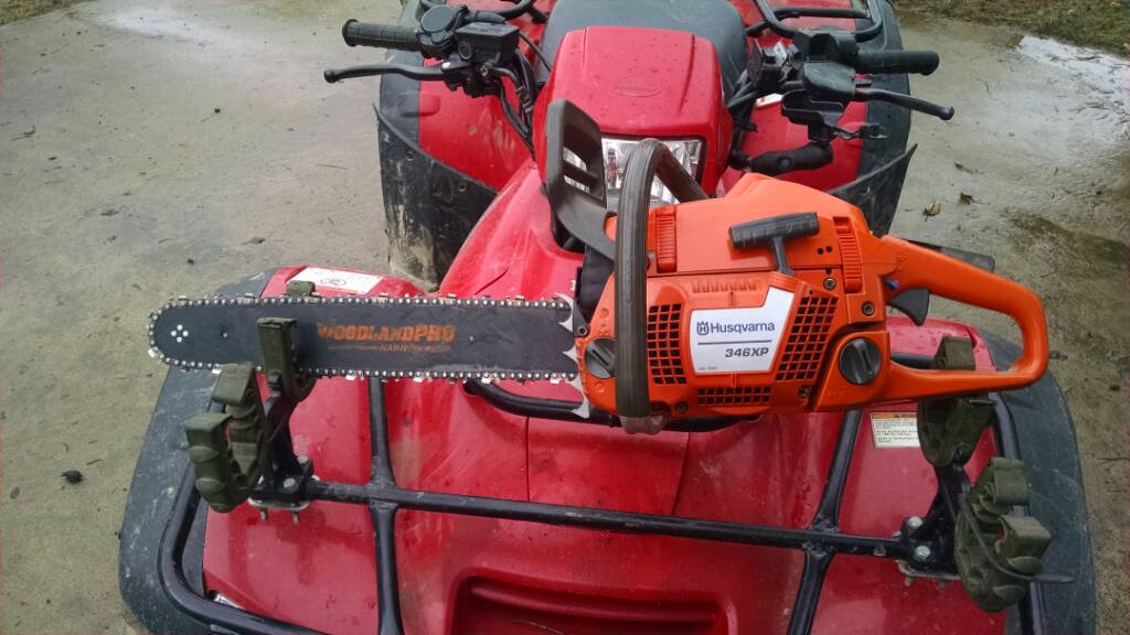

This is the one I found for $50 and sent it off to EC and he went through it and ported a 346 cylinder for it.
I messaged the seller, he said 45mm stamped on the jug, I let him know about the transfer covers, he says he was unaware of the cylinder, said he bought it that way.
He seemed pretty upfront and did change the add, then this AM he pulled the add about 7:30 pst, had zero bids.

Thanks, the average person would of probably never known.

I have 2 now that EC has done and they are absolute animals . Very happy with how they run
