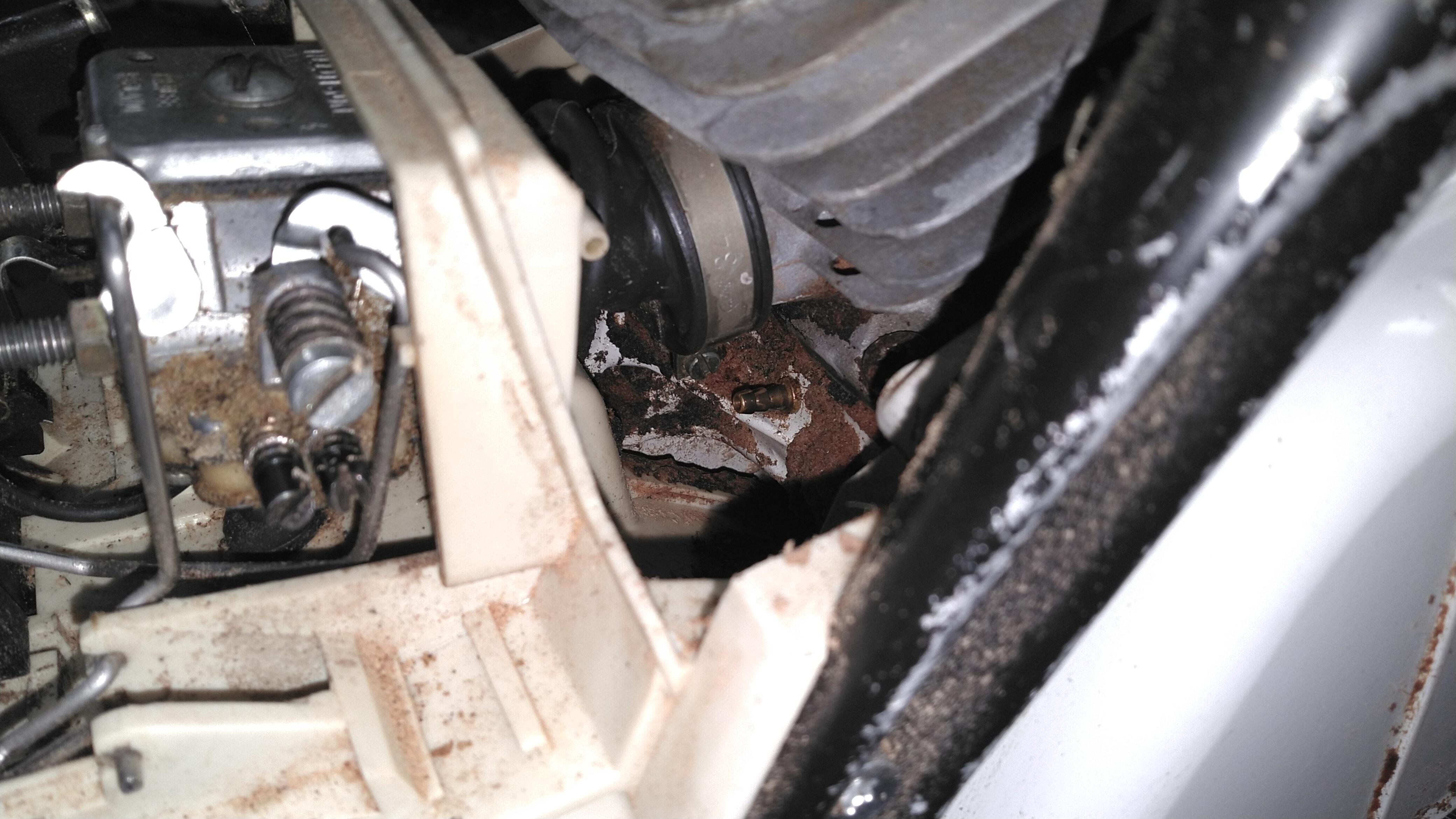

Starting to prep saws. Started with the 034 last night. Found an air leak from the intake boot and impulse hose. Have a new boot and cylinder gasket coming. Some ding dong in the past replaced the impulse hose with a hose that was too big and was loose on the crankcase nipple even with a zip tie on it... Some people just shouldn't work on saws...

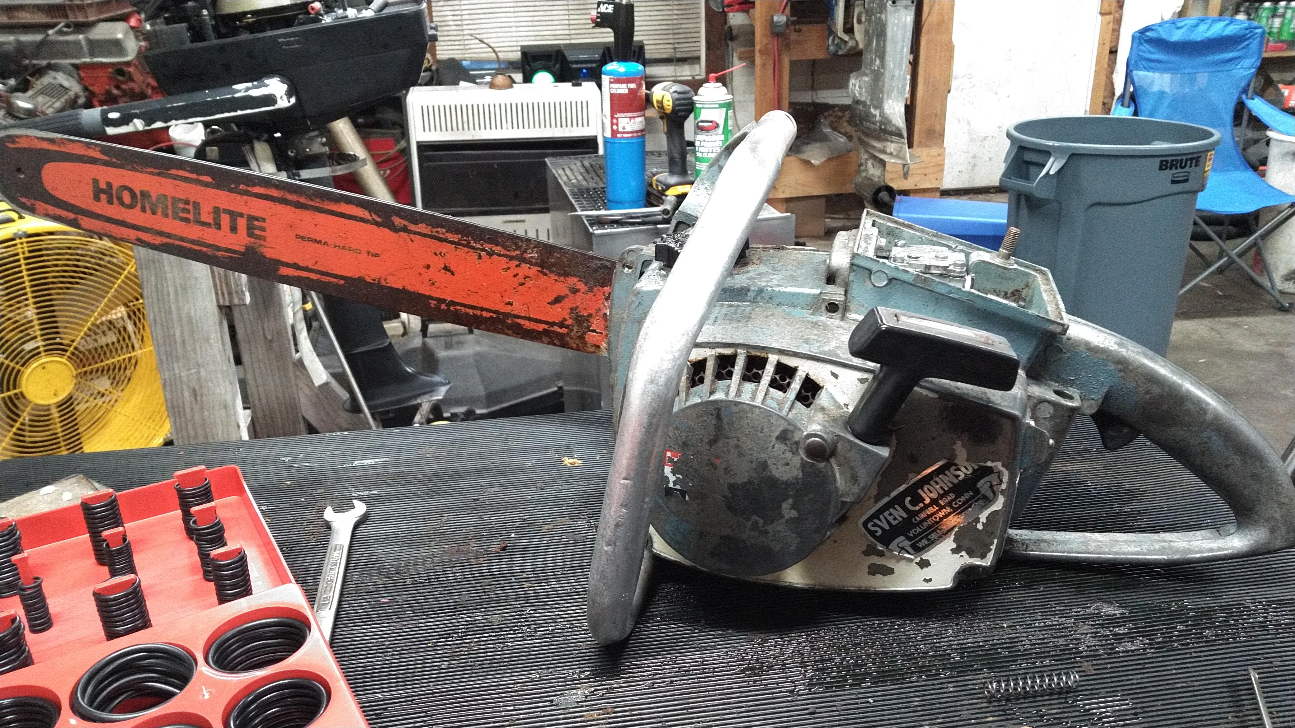

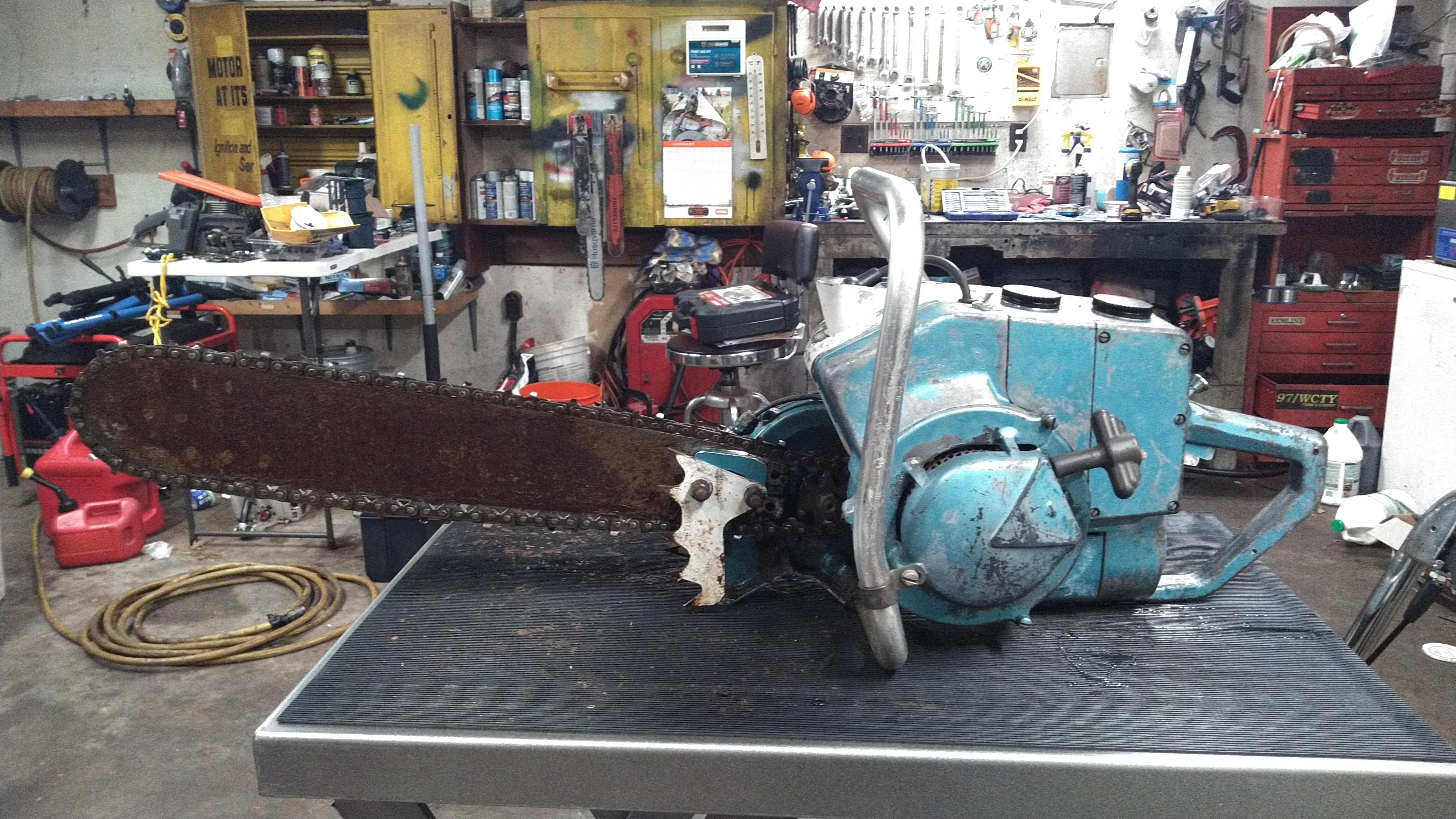

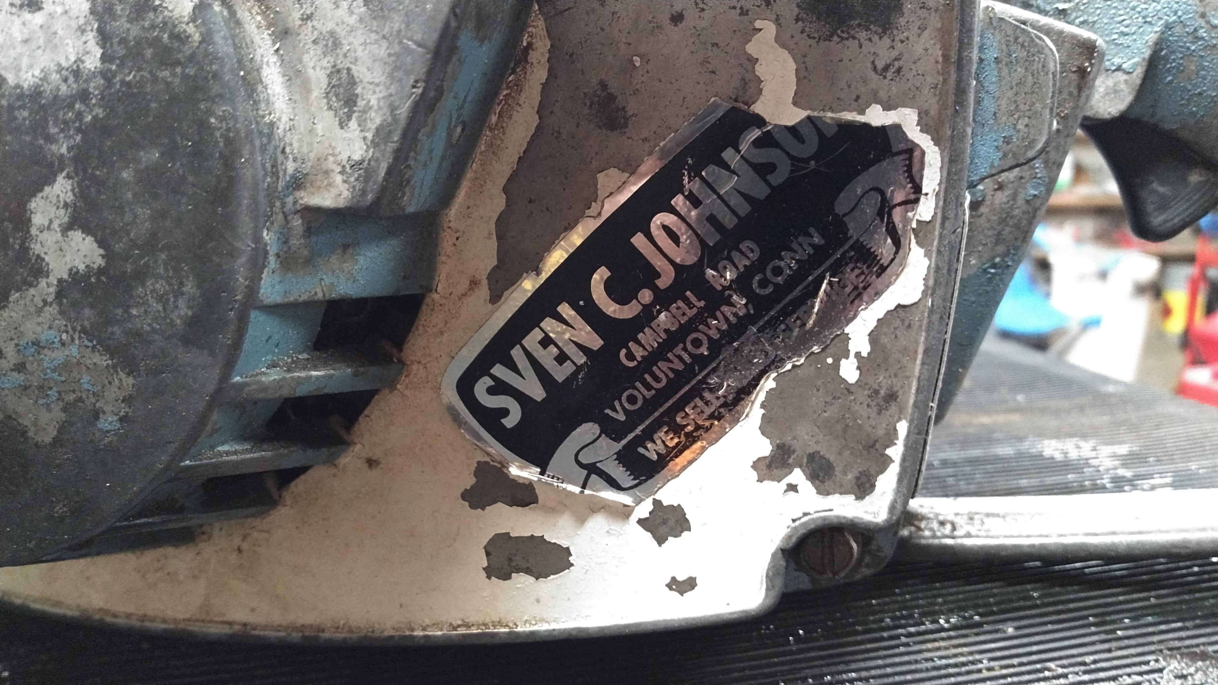

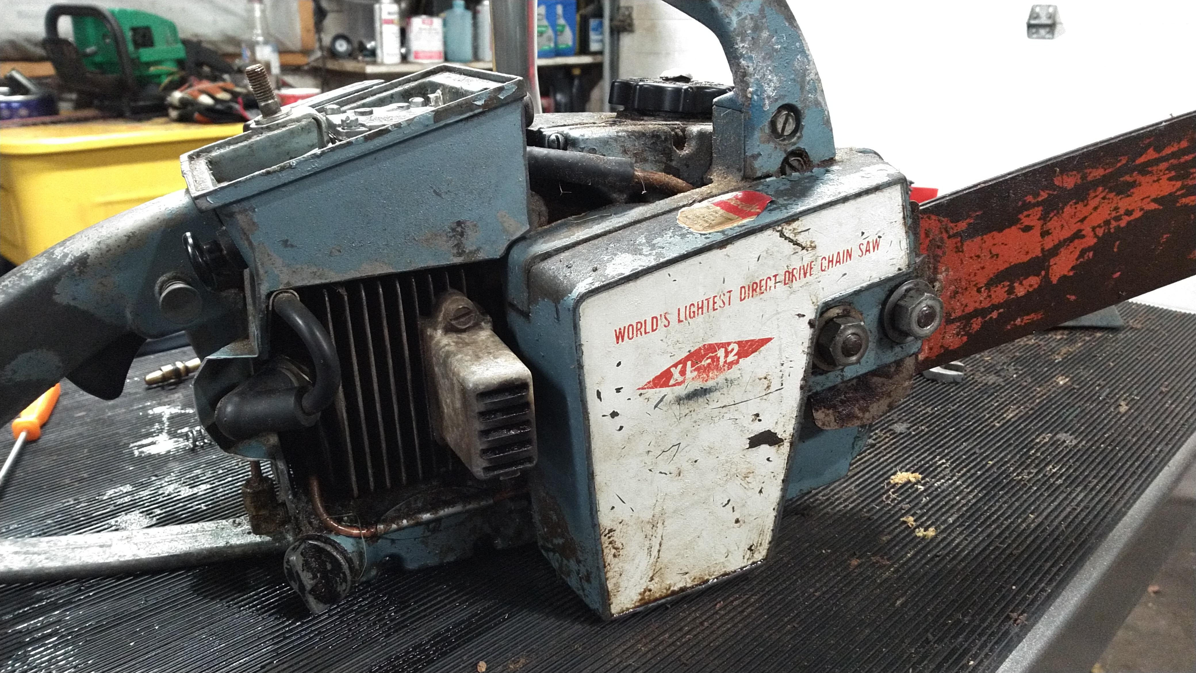

One ready to go. Homelite Super XL. New manual oiler orings and a carb tweak. One on the bench for tomorrow evening is my Sears 758G gear drive.

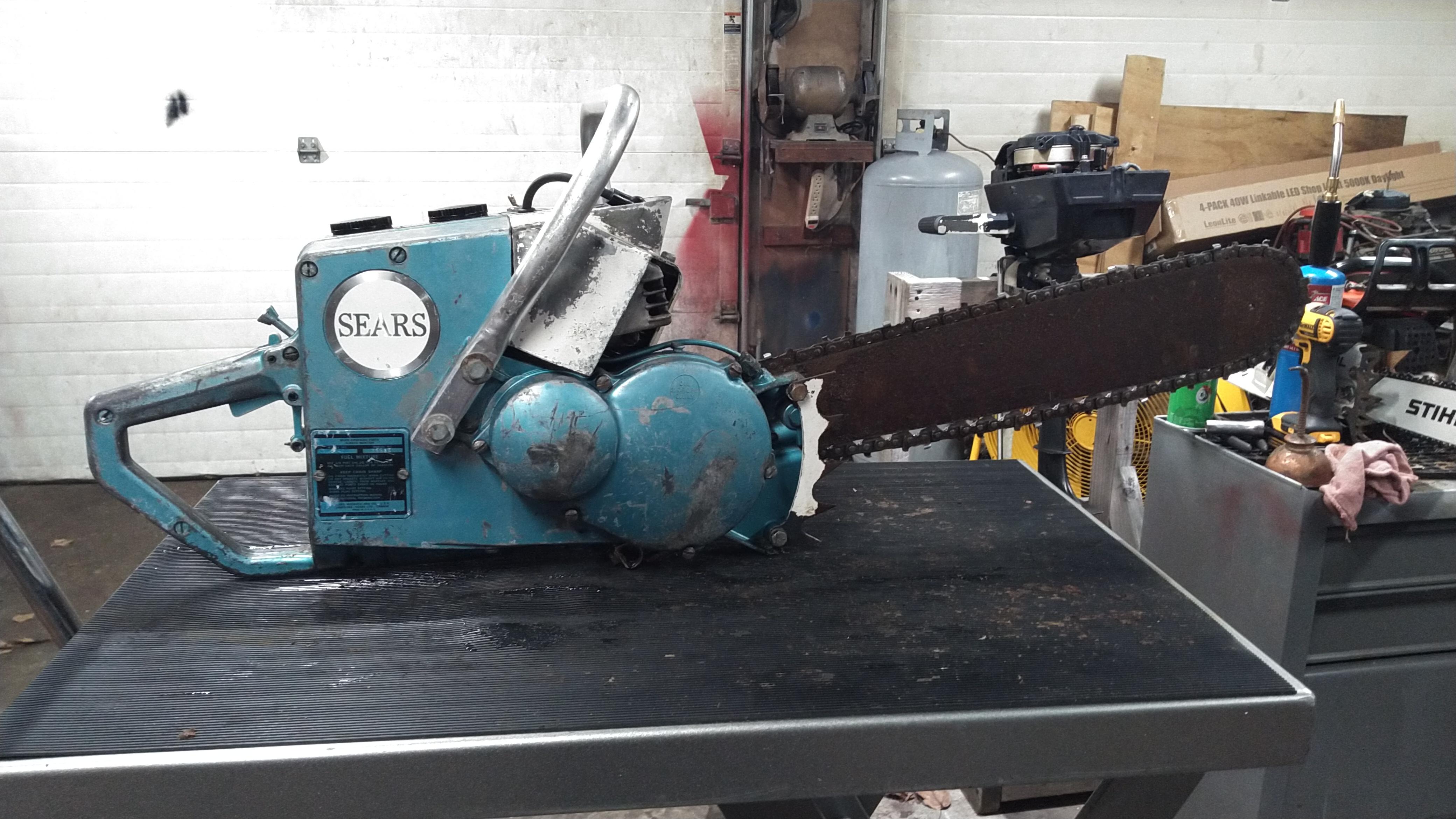

Sears monster lives again! Waiting on a chain from eBay and picking up a spinner breaker tomorrow. Also put the dual port muffler on the 346 and retuned to 13.5k and it sounds great.
