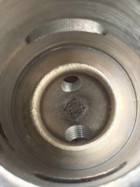

My white box (farmertek?) cylinder has minimal squish without the gasket, also a bit of 'reverse squish', .017" by the cylinder wall and .013" in towards the combustion chamber.
If someone were to fix/flatten the defect/hump on the squish band would that disqualify it for class 1?

pop a gasket in there or maybe try a different AM cylinder?
Was just a hypothetical question, I'll likely use the cross cylinder on it and who knows whether it will make it to Tn anyway.
The farmertec squishband will get flattened out, I can't get myself to use f'ed up sht like that, just bugs me.
Probably wouldn't affect performance noticeably either way but as already reported some are more extreme than this one...
