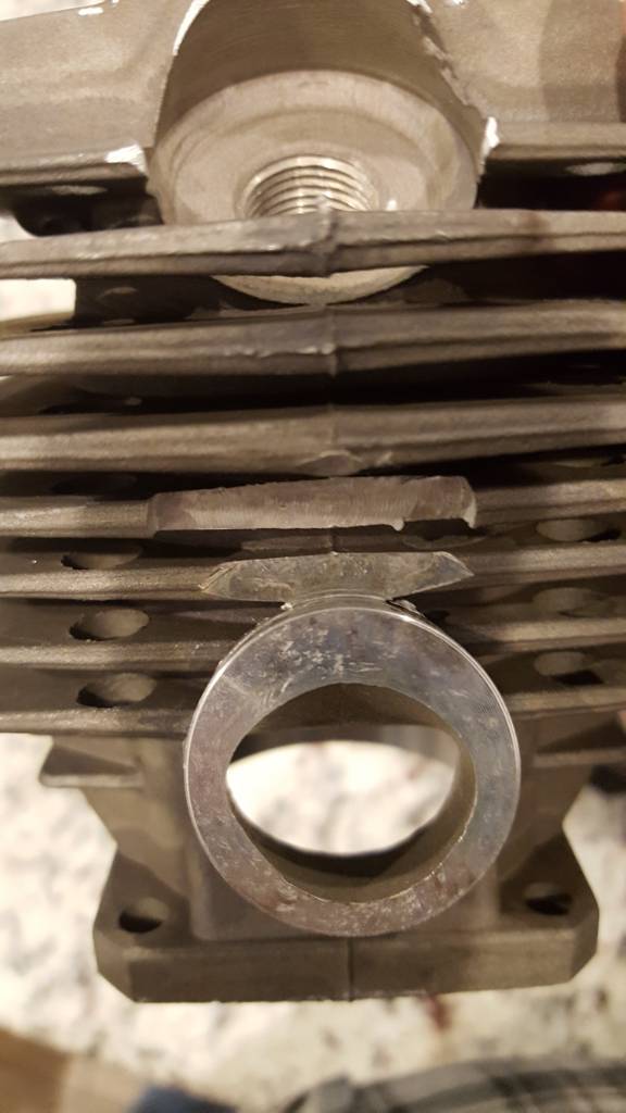

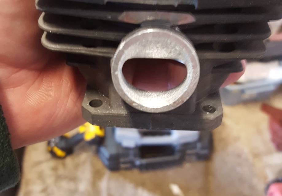

Well... I did snap some pictures and realized this throat hole needs a little love. I've got burs for that...
Bevels were OK but I did touch them up a little. No concerns there now.
Sent from my SM-G920V using Tapatalk

That's intresting, the shape of the throat, I've never taken my carb or boot off.
I'm guessing mine will need a be of TLC..:)

Well that is a very poor casting of what most have as a round hole. I've never seen one this bad actually.
