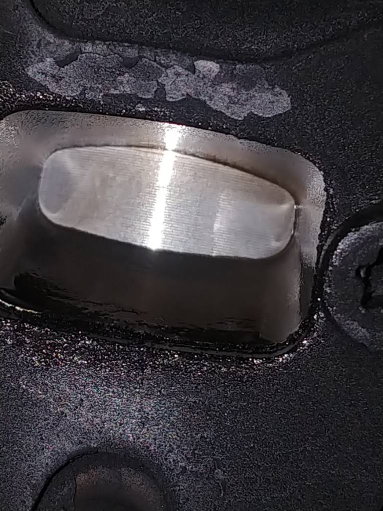

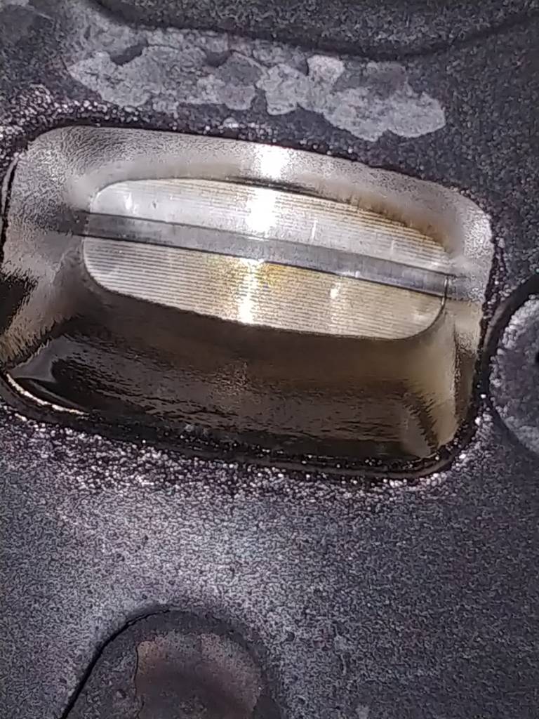

I always felt the 026/260 was a bit of an under performer stock. But I have only ran one. They are nice and light tho. The 421/4300 aren't the lightest of the bunch, but you do get otherwise tank-like build for that weight. It isn't wasted. It's big where it needs to be. I like the 242/42. Ported ones run very well. Same with the 444/44. All in all, there is certainly a place in the market for a quality, torquey 43cc saw like the Dolmar.
And, if you are willing to add finger ports to it, they freakin rip.

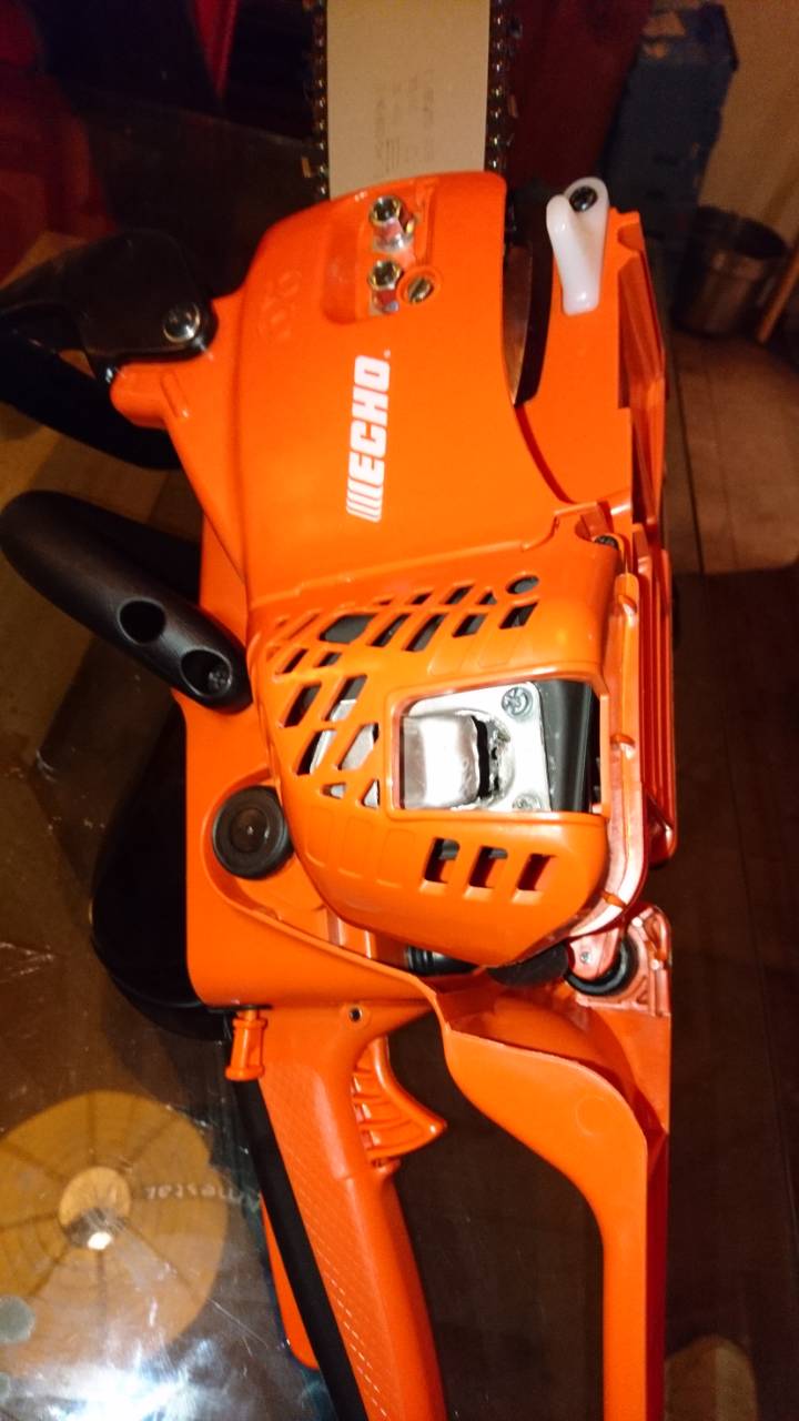

The first saw in this vid is an Echo 360 with the cat removed and the baffle removed. So it is nearly straight through exhaust. They pull strong for their displacement. The saw after the 4300 is a ported 241. It also pulls rather well. So it gives you an idea how the 4300 is running after I've ported it here. This is in an 80 year old oak limb that is as hard as any wood I have ever cut in my half century of causing trouble on this planet.
