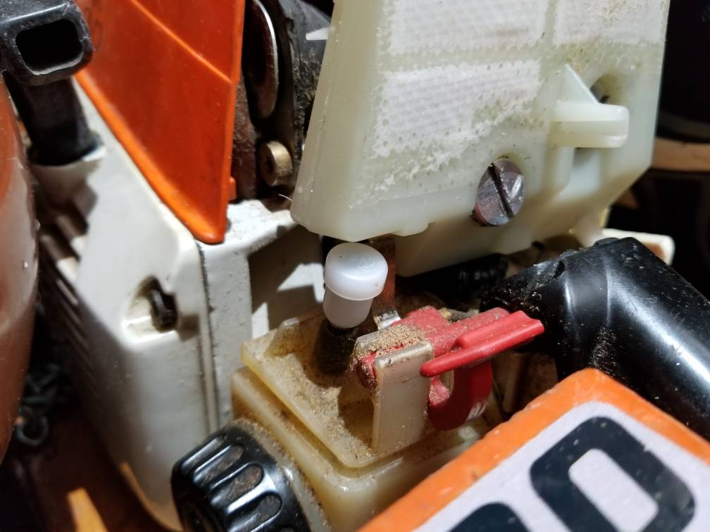

I have vent setup on the top picture . On the 026pro filter conversion, the black vent got in the way. A fuel hose inside the tank vent mount accepts a universal tank vent.

I found that the black tower tank vent doesn't work with the pro cover/filter setup. I had the aftermarket tank filter/plug/hose kits for the 026.
The filter fit on a piece of hose inside the tank opening/ not an outside mounting.
Edit: hose inside tank plastic/ vent mounted in the fuel hose.
As noted by others, an rtv would be needed for a semi permanent hose mount to the tank. The assembly fits and vents well inside the pro cover.
Thanks. So a little confused about the hose being inside the tank opening. In your close-up pic earlier in the thread, it sure looked like a hunk of fuel line slipped over the nipple on the tank just like the OEM black tower vent does, then you stuff the little vent into the other end of the line, no?
