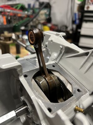

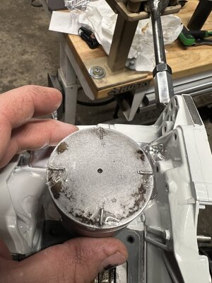

064 on the bench, cut the chamber and then base to get my desired squish. Landed on .023 PTO .0235 flywheel, l checked 1 side at a time.
I seen a post recently where squish was checked using 2 small pieces greased to the piston. I liked the idea, eliminate “rock” in the piston and bearing tolerances. So I thought I would check that way also. After doing that it came out .017 both sides.
Pretty surprised by the difference.
This is with new crank bearings and wrist pin bearing installed. This piston does have skirt wear and cylinder is well used, which I’m sure could contribute to the vast difference in readings. But I was still surprised. Makes me concerned about a few saw I built with squish at .020 checked 1 side at a time.
How do you do it? I’m thinking I will change my way from here forward. Few build pics. Forgot to take some of squish process.

A reputable builder I know always used three pieces. It would keep the piston squared up to the combustion chamber. I asked this question on a pic he sent me. LOL

If you’re checking squish one spot at a time then the best place is PTO or FW sides. But it’s always more accurate to use four points. PTO, FW, Intake, Exhaust. The bad news is that with the rings installed is even more accurate.
My usual process is to check the PTO side before disassembly. I usually check it a few times in the machining process using just the PTO and FW. Before final assembly I test all four points (without the rings).
Make sure you use the right piston and base gasket for all measurements.
If I’m just checking squish, I just check the PTO side with the saw assembled. It’s not quite as accurate, but I don’t need it to be.

I've had the same results as you when checking in a single spot vs using grease and 4 pieces of solder.

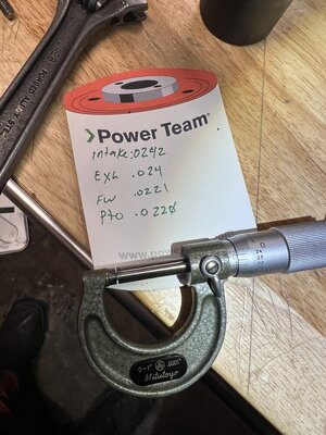

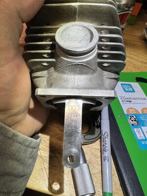

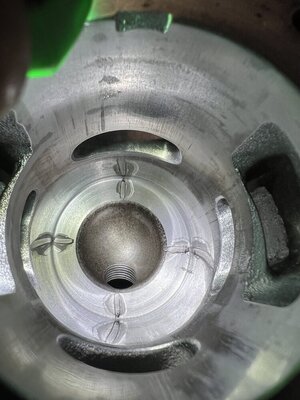

Admittedly I did not roll over several time during first checks. Could have contributed to discrepancies. I wish I rechecked before I recut. I bought home my good mic to check.
Tonight I cut .007 from band, and did a 4 point check with .050 solder, all I currently have on hand.
.050 to big?
.0242 intake .0240 Exh .0221 FW .0220 PTO.
Not sure on .002 difference?? Thoughts?
Doing a single point check with several rolls
FW .0277
PTO .0270
Checking skirt clearance, .003 does fit in the lower jug but tight. .0025 fits with a drag. Too loose?
Rod bearing no noticeable radial play, pin bearing new and feels good in bore, pin is used till new one arrives at dealer. Very snug pin fit in piston bosses.

IMHO, most discrepancies with squish come from the solder springing back, or not being crushed enough times.
The solder should be as near possible to intended squish size before crushing. I use .026 solder and I’ve found that, in general, it should feel like the piston isn’t even being stopped by the solder when it’s turned over by hand. I go over the piston pin on the fly side and spin the motor over with a drill. I’ve never had a problem with this method and find it the most accurate.
I’ve personally found the rocking it back and forth by hand with solder over 26 thou to be the most inaccurate method. I used to wind up finding an inaccuracy in too large of a squish only to find that I made it too tight afterwards because of chasing that error.
People use .020 as the goal for squish, but I’ve seen saws run for years that weren’t measured correctly and were actually at 10-12 with no detriment at all.
I like 15-16 in smaller saws and 18-20 in bigger ones.

Your skirt clearance should be ok, but it’s getting close.
Using .050 solder is just gonna be super inaccurate IMHO. I use 3 different sizes for checking squish. It’s surprising how much one can be fooled by any sized solder. If I have to twist solder to get a reading before a base cut, I almost always take 5-10 less off the base than its says I should. Generally it’s safer that way. Then I take my Final Cut after figuring out where I am with different solder as I get closer to goal.

Definitely get smaller solder. I like 0.032”. I can’t remember the chemistry off hand but it’s softer than a lot of solder. Just a personal thing, but if all four points are stuck in the chamber I feel like I had to use too much force to turn it over.

I had a feeling as after several time rolling over I could still feel solder. I found some 1/32 or .0312 in my work toolbox, I’ll recheck that this evening.

I will. You were definitely right on getting fooled. Rechecked last night with .31 wire and had close to .003 difference from the larger solder. Ran that 3 times to confirm.
That being said, also only had .003 difference checking single point over flywheel or pto.
Still don’t love the .002 variations over int/exh vs fw/pto. One would think if band or base cut was off you’d be hi/low. That and I rolled both in under .0005 and felt very good with it.

I just check it over the intake and exhaust, then average the two. There is always going to be a bit of piston rock, so you have to measure at least two opposite points at a time.
I use 3 strands thin rosin core solder (0.032") twisted together so it squishes with less force.
